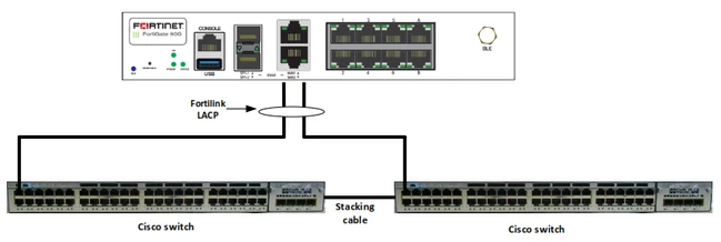

This article describes how to connect FortiGate to third party switches, Cisco pair of switches as an example, via FortiLink interface with LACP.
FortiGate and a pair of Cisco switches.
There are various circumstances where non-Fortinet switches need to be connected to FortiGate firewall with some level of redundancy and load balancing. This simple solution shows how to connect and configure FortiLink port on FortiGate with LACP to communicate to Cisco switches that formed a distributed port channel to FortiGate. Moreover, this solution uses ports WAN1 and WAN2 on FortiGate to reserve high speed SFP+ ports for uplinks to external networks or Internet
Physical connectivity topology is shown below to demonstrate it:

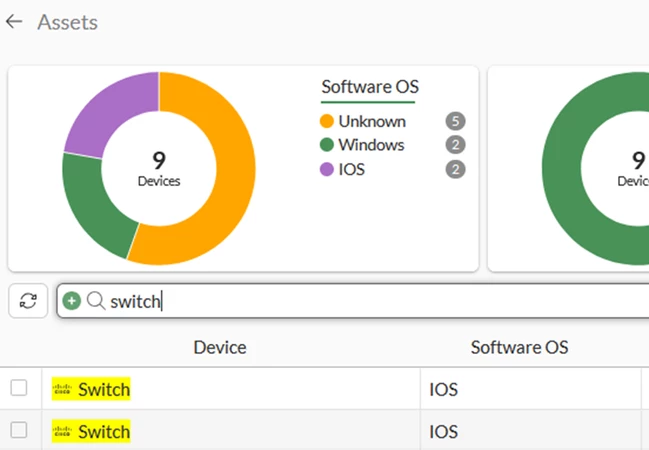

And finally this can also be confirmed on FortiGate by checking detected devices in Assets:
