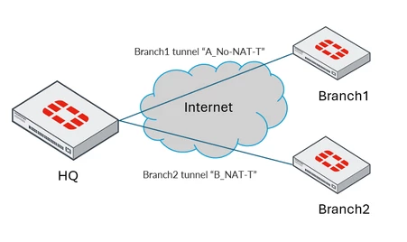

Topology:
The HQ FortiGate has 2 tunnels for 2 branches with the same proposal, but the difference is branch 2 tunnel 'B_NAT-T' has NAT traversal. Peer ID is used to identify the branch.
