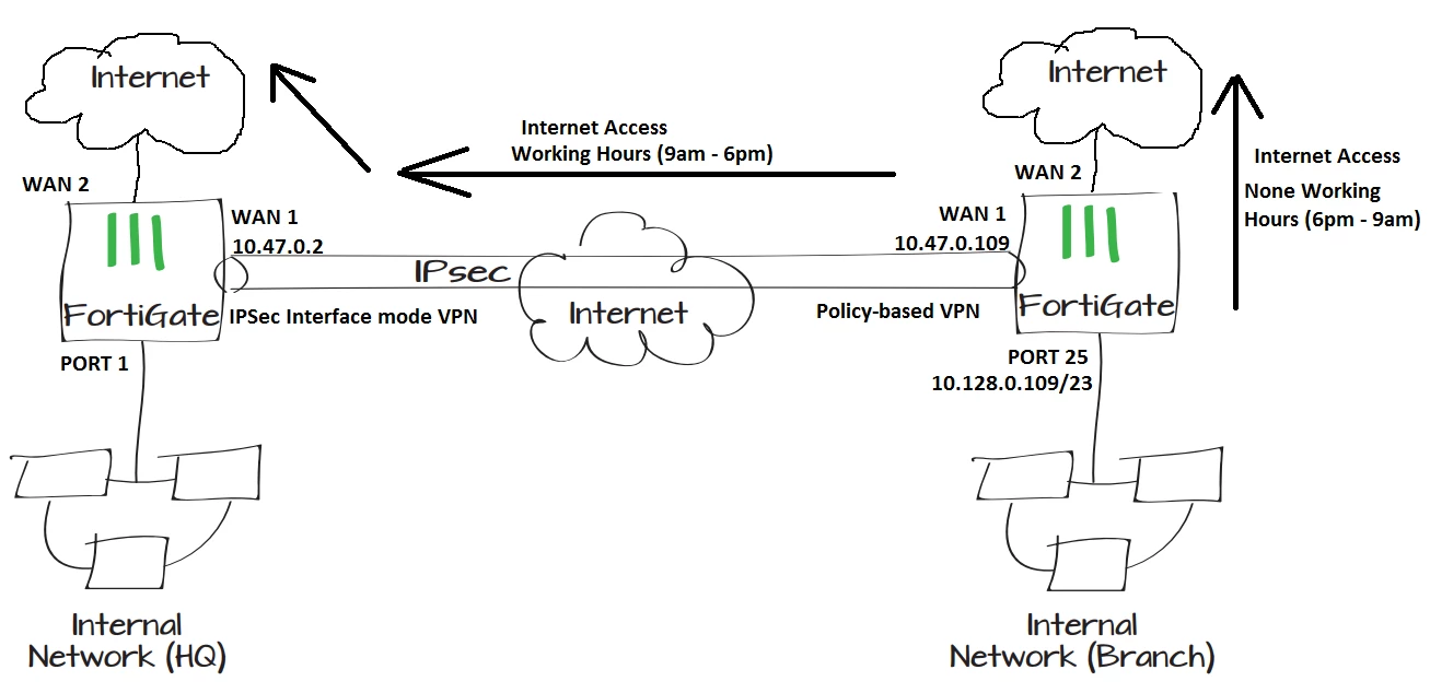

This article describes how to have remote branch to route all internet traffic to HQ on a specific schedule only and utilize own default route when outside of that schedule
Note: Both static route and policy route do not support schedule option, however using a Policy-Based VPN and “Schedule” feature with an IPSec firewall policy on the FortiGate at the branch and an IPSec Interface mode on FortiGate at HQ will enable this solution.
Configuration example:

Branch

5. Create Schedule on FortiGate at Branch

6. Configure IPSec security policy on FortiGate at Branch
config firewall policy
        set name "vpnpolicy"   < --- to allow & forwardBranch local segment to access internet via HQ

        set name "to_internet" < -- to allow Branch local segment to access internet via default route
