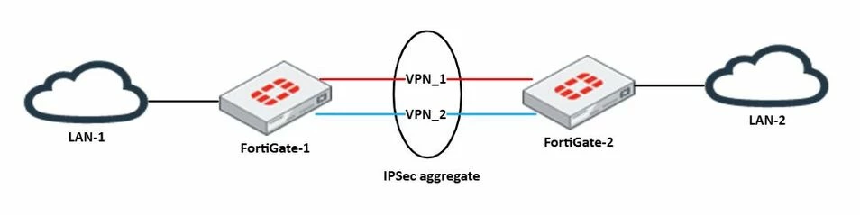

Example topology:
There is an IPSec aggregate between FortiGate-1 and FortiGate-2 with 2 IPSec members. With the current change of behavior, all routes on FortiGate-1 and FortiGate-2 associated with IPSec aggregate will stay up even if the IPSec aggregate us down. In order to make all routes associated with the IPSec aggregate inactive when it's down, a Link-monitor could be used.
