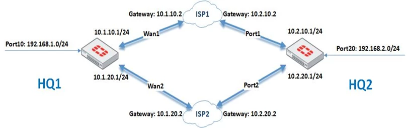

This article explains the use of IPsec aggregate for redundancy and traffic load-balancing.
This feature allows to load-balance traffic and set up redundancy on multiple site-to-site IPsec VPNs.
L3, L4, round-robin, and redundant load-balancing algorithms are supported.
L3                   : Use layer 3 address for distribution.
L4                   : Use layer 4 information for distribution.
round-robin          : Per-packet round-robin distribution.
Redundant            : Use the first tunnel that is up for all traffic.
Limitation: Since FortiOS v7.0.1, all routes associated with IPsec aggregate are not marked 'inactive' if the IPsec aggregate is down. IPsec aggregate interface is always UP. As a workaround the approach using a 'link-monitor' described in Technical Tip: IPsec aggregate with link-monitor.
Note: Another workaround to overcome the limitation introduced in 7.0.1 could be to add the aggregate tunnels to SD-WAN zone, then a performance SLA should be configured over the aggregate tunnel to a remote server. Once the remote server is no longer reachable over aggregate tunnel, the performance SLA will go out of SLA and the SD-WAN rule that forwards traffic over that particular aggregate tunnel will fail/stop forwarding, therefore FortiGate stopped using the affected (down) aggregate tunnel.
Note 2: IPsec aggregate will only handle network endpoints, such as subnets or sites, no individual user connections where user/user groups authentication processes can be involved
FortiGate.
Configuration of FortiGates using CLI:
Here is the step-by-step guide:
HQ1 – System Interface and Static Route Configuration:
config system interface
    edit "wan1"
        set ip 10.1.10.1 255.255.255.0
    edit "wan2"
        set ip 10.1.20.1 255.255.255.0
config router static
        set gateway 10.1.10.2
        set device "wan1"
        set gateway 10.1.20.2
        set device "wan2"
        set priority 20
HQ2 – System Interface and Static Route Configuration:
    edit "port1"
        set ip 10.2.10.1 255.255.255.0
    edit "port2"
        set ip 10.2.20.1 255.255.255.0
        set gateway 10.2.10.2
        set device "port1"
        set gateway 10.2.20.2
        set device "port2"
        set priority 20
HQ1 – IPsec VPN Configuration:
    edit "Pri_VPN_to_HQ2"
        set interface "wan1"
        set peertype any
        set net-device disable
        set proposal aes128-sha256 aes256-sha256 aes128-sha1 aes256-sha1
        set remote-gw 10.2.10.1
        set psksecret sharedKey1!
        set aggregate-member enable
    edit "Sec_VPN_to_HQ2"
        set interface "wan2"
        set peertype any
        set remote-gw 10.2.20.1
        set psksecret sharedKey2!
        set phase1name "Pri_VPN_to_HQ2"
        set proposal aes128-sha1 aes256-sha1 aes128-sha256 aes256-sha256 aes128gcm aes256gcm chacha20poly1305
        set auto-negotiate enable
        set phase1name "Sec_VPN_to_HQ2"
config system ipsec-aggregate
    edit "Agg_VPN_to_HQ2"
        set member "Pri_VPN_to_HQ2" "Sec_VPN_to_HQ2"

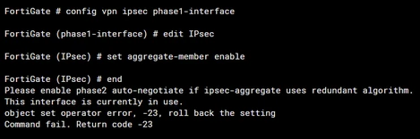

Note: When enabling the 'aggregate-member' option on existing tunnels, it is necessary to remove all references such as firewall policies and static routes. Otherwise, the following error message will appear and it will not be possible to enable the 'aggregate-member' option.
HQ2 - IPsec VPN Configuration:
    edit "Pri_VPN_to_HQ1"
        set interface "port1"
        set peertype any
        set remote-gw 10.1.10.1
    edit "Sec_VPN_to_HQ1"
        set interface "port2"
        set peertype any
        set remote-gw 10.1.20.1
        set phase1name "Pri_VPN_to_HQ1"
        set phase1name "Sec_VPN_to_HQ1"
    edit "Agg_VPN_to_HQ1"
        set member "Pri_VPN_to_HQ1" "Sec_VPN_to_HQ1"
