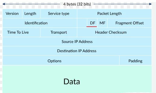

Factors affecting fragmentation decision for traffic to be sent over IPsec tunnel:
  1. DF bit in IP header: The DF bit is a bit within the IP header which instructs routers whether fragmentation of this IP packet is allowed or not.
  • DF = 1 (Fragmentation is NOT allowed).
  • DF = 0 (Fragmentation is allowed, if necessary).
