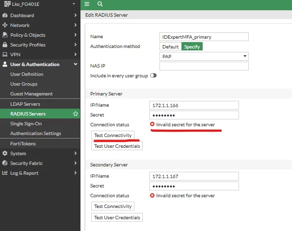

Description This article describes the situation of 'Invalid secret for the server' showing up after Blast RADIUS mitigation of FortiGate v7.2.10, v7.4.5.
Scope FortiGate.
Scenario:
After upgrading FortiGate to v7.2.10, v7.4.5 and following the KB article: Technical Tip: Workaround for Blast RADIUS mitigation behavior in v7.2.11, v7.4.6 and v7.6.1, the backend of RADIUS authentication is working fine but GUI shows error as below.
Solution:
It is a known GUI issue with no backend impact and fixed on firmware v7.2.11, v7.4,.8 and v7.6.1.
The user can confirm the connection to the RADIUS server via the CLI command:
diagnose test authserver radius <server> <method> <user> <password>
