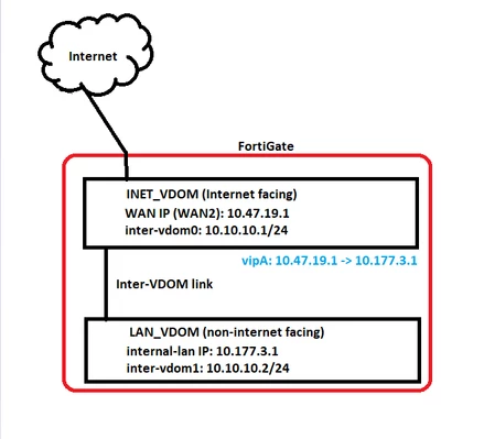

Description This article describes how to set up a Single NAT VIP on the Inter-VDOM link. This is for cases where 1 VDOM has Internet access and the other VDOM does not have Internet access.
Scope FortiGate 6.0.x, 6.2.x, 6.4.x, 7.0.x 7.2.x  - Single NAT.
Topology:
INET_VDOM -> Internet facing VDOM
LAN_VDOM -> VDOM with no Internet; LAN VDOM.
Goal:

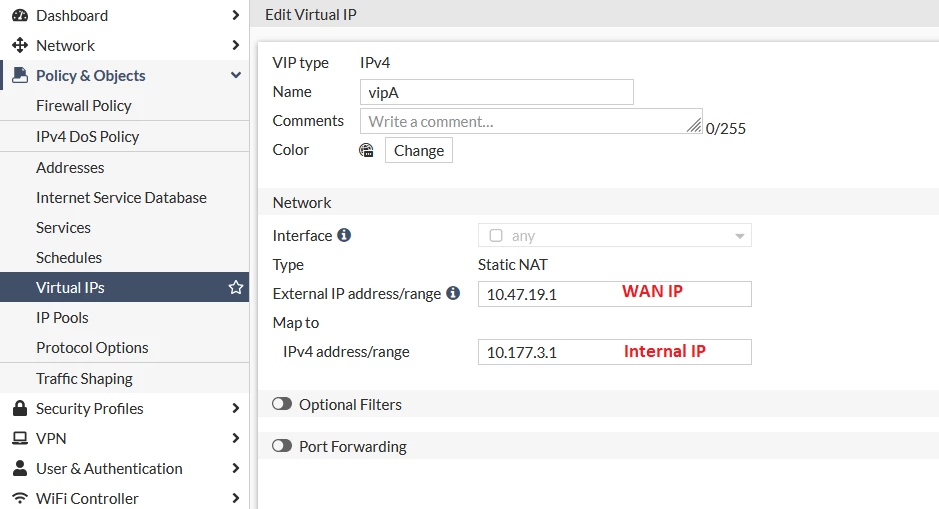

The result wanted is to reach the internal-LAN IP (10.177.3.1) from the External IP (10.47.19.1).
Create a VIP object on the Internet-facing VDOM, vipA: 10.47.19.1 -> 10.177.3.1. This VIP directly maps the external IP to the internal-LAN IP.

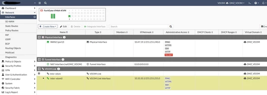

Interface:

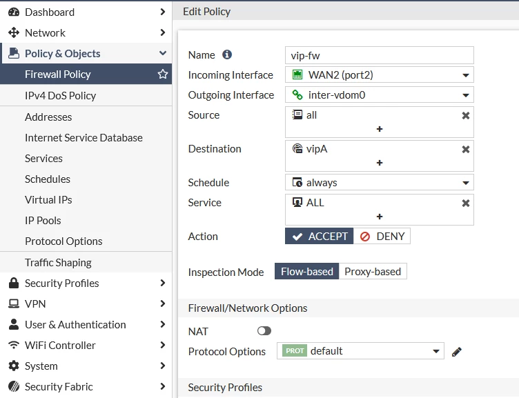

Firewall Policy:

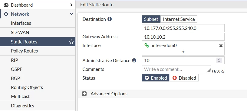

Static Route:

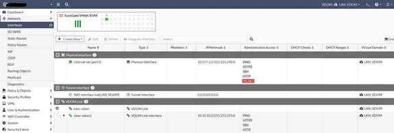

LAN_VDOM (Non-Internet facing vdom) configuration:

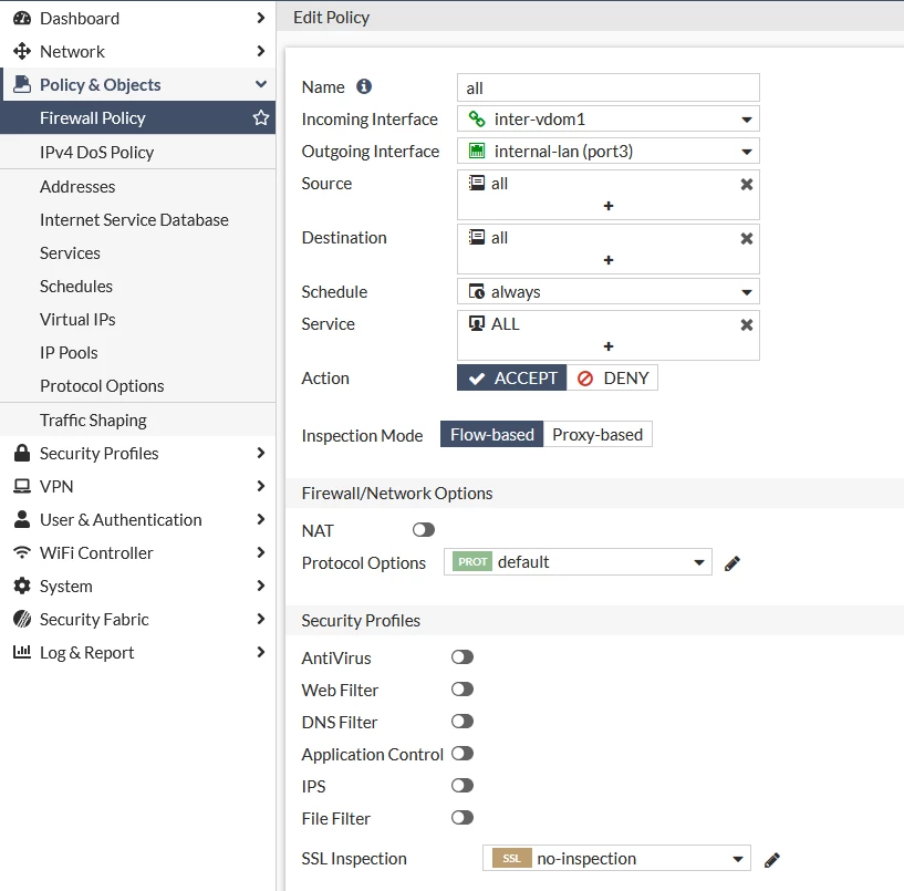

Firewall Policy:
Static Route:

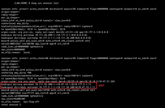

Result:
This is how the Session Table should look like.
Session Table Filters used:
# diag sys session filter ext-dst 10.47.19.1    -> (wan ip)
# diag sys session filter ext-dst 10.177.3.1    -> (internal ip)
# diag sys session list
In this screenshot, 10.111.36.200 is the IP pinging the WAN IP of INET_VDOM.
