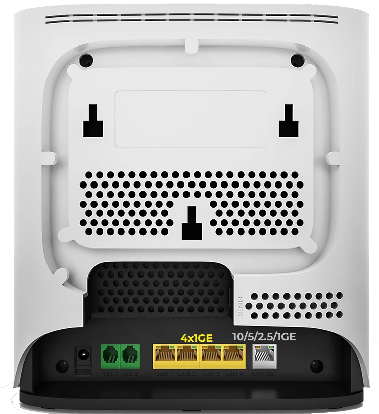

Bell Fibe is a Canadian residential fiber-to-the-home provider where the service is currently provided via a combination Router/Modem given to the subscriber. The 'Giga Hub' device provided by Bell is required to access the service and does not provide a typical 'bridge-mode' functionality that can be toggled on or off to deactivate the routing functionality and behave only as a modem. Instead, the Giga Hub supports PPPoE pass-through while the internal router functionality remains active.
This differs from previous iterations of the modem used by Bell, such as the 'Home Hub 3000', where the SFP transceiver was removable and could be inserted into an SFP port on the FortiGate directly. With the 'Giga Hub', the transceiver is built in and soldered, meaning the method in Technical Tip: Bell Fibe configuration directly on the FortiGate is no longer possible for new subscribers.
These steps assume that the Giga Hub is already functional and connected to an interface on the FortiGate via the 4xGE Ethernet ports (yellow), or the single 10/5/2.5G/1G Ethernet port (metallic) at the back of the modem. If the service speed exceeds 1 Gbps, consider using the metallic port with the appropriate speed on the FortiGate interface (SFP+, 10G-Base-T, or multigig Ethernet).
The example below makes use of the X2 port on a FortiGate 101F with the FN-TRAN-SFP + GC transceiver to connect to the 10G port on the Giga Hub. No special configuration is needed on the Bell Giga Hub, but if the FortiGate is being used with FortiAP or FortiWiFi, it is recommended to turn off the wireless functionality of the Giga Hub.

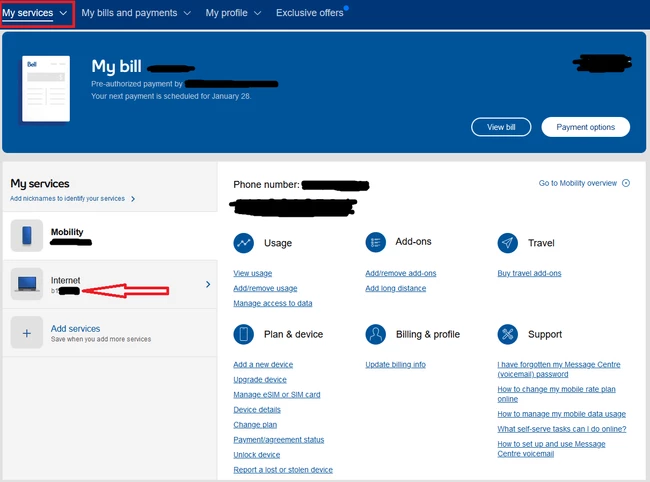

    1. For Bell Canada, the PPPoE username always starts with 'b1.....' and is not the login used to access the customer portal. Rather, this username will be visible on the customer portal under 'My Services' for 'Internet'.
    1. The password is often provided with the welcome letter. If a welcome letter was never received, Bell support can reset this password if needed.

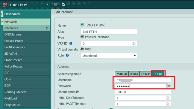

    2. Navigate to System -> Interface -> x2.
    3. Switch the mode to PPPoE and provide PPPoE Credentials, then select 'OK' when complete.

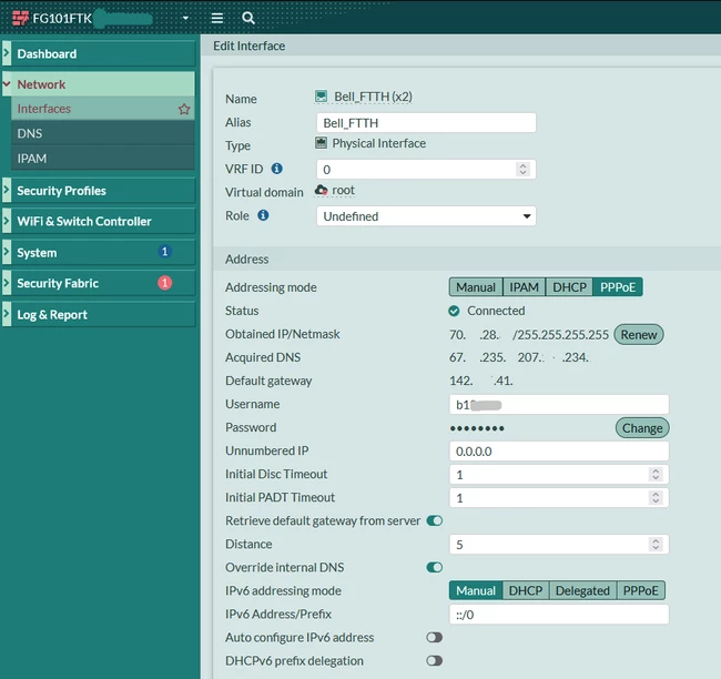

  1. The interface should now show a public IP obtained via PPPoE.
