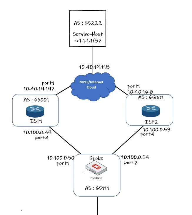

  1. Service-Host device is hosting 1.1.1.1/32 prefix.
  2. The spoke firewall has two uplinks from the same service provider AS-65001.

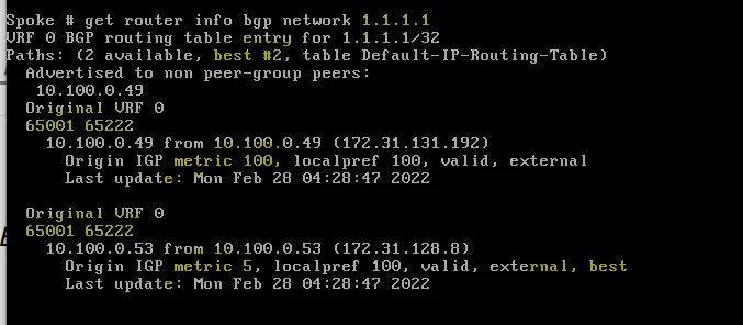

  1. Prefix 1.1.1.1/32 has been selected best from ISP2 (next-hop 10.100.0.53) since the metric is lower than ISP1.
