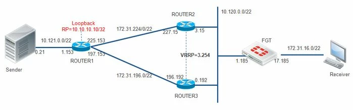

This article describes the reasons behind multicast packets being unable to traverse the FortiGate unit, despite the presence of a static route configured to utilize a VRRP, HSRP, or GLBP address for reaching a PIM sparse-mode RP.
FortiGate.
Sample Network Topology:
  1. The FortiGate unit in the above topology forms a PIM-SM neighbor relationship with ROUTER2 and ROUTER3.
  2. The multicast receiver initiates an IGMP JOIN request expressing its desire to receive a stream destined to multicast group 239.121.1.1. The following output demonstrates that FortiGate has successfully processed the IGMP JOIN request and has recorded the receiver's subscription to the stream.

  1. Multicast Rendezvous Point (RP) is configured on ROUTER1 and is reachable from the FortiGate.

The multicast routing table on FortiGate displays only one entry for Multicast Group 239.121.1.1. This entry is created by the IGMP join messages received on the port1 network interface of FortiGate facing the receiver.

The absence of an (S, G) entry indicates that no multicast stream has been received at the FortiGate. This is attributed to FortiGate's failure to forward the IGMP JOIN(*, G) message to the RP.
PIM debugs indicate that the FortiGate is not generating a PIM Join towards the RP due to 'No RPF neighbor for (*, 239.121.1.1)'.

id=0 msg="PIM-SM: US (*,G): No RPF neighbor for (*, 239.121.1.1)" <-------- RPF failure
id=0 msg="PIM-SM: US (*, 239.121.1.1): NOT JOINED to JOINED, JoinDesired(*,G) => TRUE "
RPF check fails because the next hop to reach the RP is 10.120.3.254, which is not a PIM neighbor. 10.120.3.254 is a VRRP Virtual IP address.
  1. The next-hop for the FortiGate to reach RP according to the routing table is 10.120.3.254 (VRRP Virtual IP Address).

    Firewalls and routers that are not VRRP-aware typically anticipate a PIM neighbor as the next hop to reach the RP, rather than the VRRP virtual IP address.
  1. In the current network topology, FortiGate recognized 10.120.3.15 (ROUTER2) and 10.120.0.192 (ROUTER3) as PIM neighbors and not 10.120.3.254.

When PIM-SM is set up with routes to the RP directed to the VRRP virtual IP address, it can result in RPF check failures.
To address this issue, configure VRRP-aware PIM on FortiGate as below.

'rpf-nbr-fail-back' is used to enable or disable this feature. When this feature is enabled, in the event of an RPF check failure, the system will select the neighbor with the highest DR selection priority. The 'rpf-nbr-fail-back-filter' is employed to manage the eligibility of neighbors for the fail-back selection process.
Workaround:
Configure a more specific route pointing to the RP address, using the physical interface addresses as the next hop instead of the VRRP Virtual IP address. This can be achieved with either a static route or a dynamically learned route.

Verification:
FortiGate now forwards the PIM JOIN and receives the stream from the multicast source.
PIM assert messages received by FortiGate will override RPF neighbor selection. When FortiGate receives the ASSERT message from a neighboring device, the RPF neighbor will be overridden.
