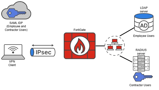

For example, see the following diagram. If a single VPN dialup gateway has firewall policies with user groups for all the authentication sources in the following diagram (RADIUS, LDAP, SAML), only RADIUS users will be able to authenticate to the VPN tunnel.
If multiple RADIUS servers are referenced in remote groups, only users existing on the first configured RADIUS server will be able to authenticate.
