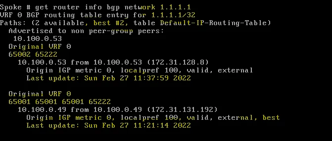

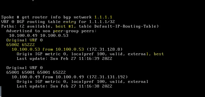

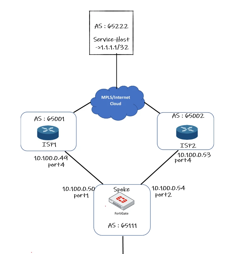

  • Spoke firewall receiving prefix 1.1.1.1/32 from both ISP1 [AS-65001] and ISP2 [AS-65002]
  • The best route has been selected via ISP2 due to the shortest AS Path.
  • After applying bestpath-as-path-ignore, reset the bgp connection for ISP2[AS-65002].
  • Now the best path has been selected of ISP1[AS-65001].
