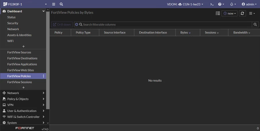

However, since the logging is now being offloaded and handled directly by the NP7 hardware, the FortiGate CPU will no longer have direct visibility to these logs, nor will it have direct access to the session table. This affects functions like FortiView, where it is impossible to view information regarding hardware sessions in real-time or historically. For example, visiting the FortiView Policies page within a Hyperscale VDOM with hardware logging will result in a page showing a 'No results' message:
