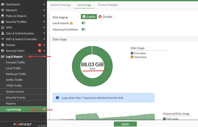

Go to the Log & Report tab -> Settings -> Local logs.
The available storage space on the FortiGate 61F serves as an example, as each FortiGate comes with a different storage capacity.

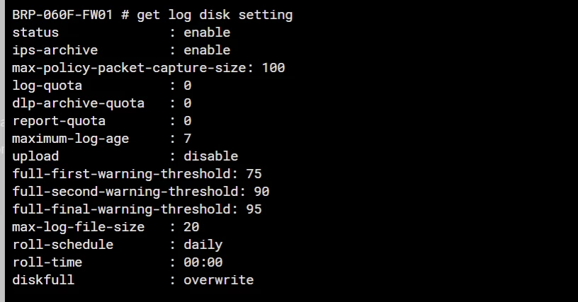

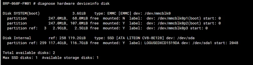

To review the storage capacity from CLI:
get log disk setting
diagnose hardware deviceinfo disk

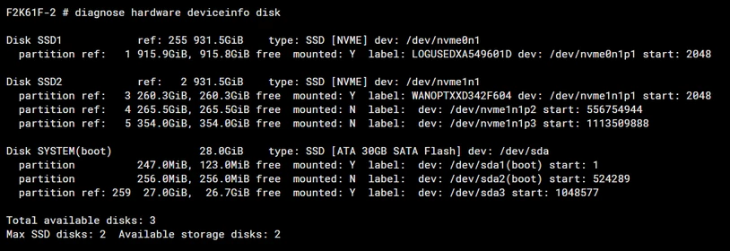

Here is another example of a FortiGate model but with multiple disks:
The log retention Period by default is configured to store logs for up to 7 days. Logs older than this period are automatically purged.
