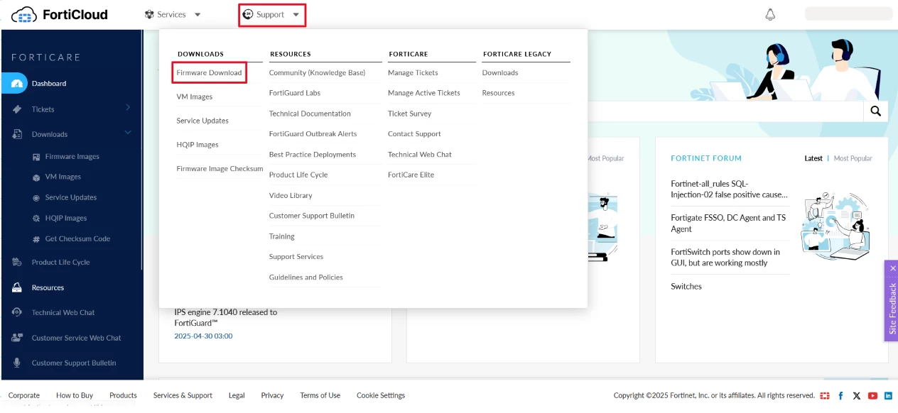

In this scenario, FortiGate 200F is on v7.0.17 build 0682, and it is required to check the upgrade path for v7.6.3. Go to Fortinet Support Portal and log in to the account and go to Support -> Firmware Download.

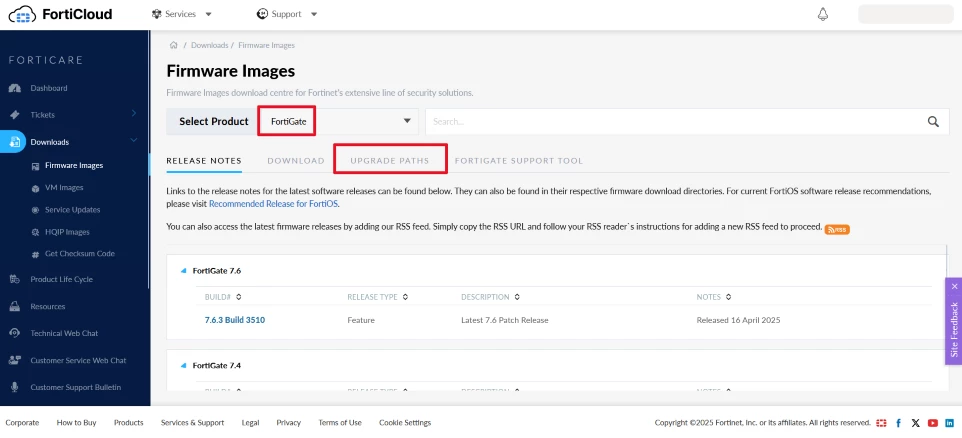

Choose FortiGate under 'Select Product'.
Then select the 'Upgrade Paths' button.

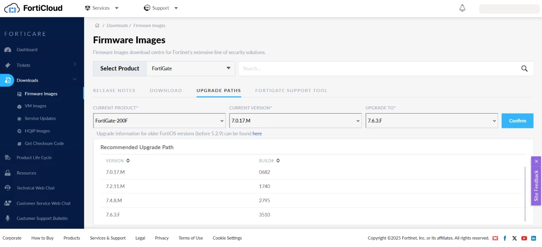

Under 'Current Product', choose the relevant FortiGate Model (In this scenario: FortiGate-200F).
Choose the current Firmware version under 'Current Version' drop-down (In this scenario: 7.0.17).
Select the target Firmware version under 'Upgrade To' drop-down (In this scenario: 7.6.3).
Then select the 'Confirm' button.
Following this, the upgrade path will show up.

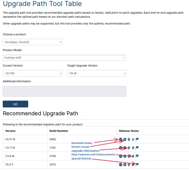

From Upgrade Path Tool
Alternatively, it is possible to check the recommended upgrade path from Upgrade Path Tool Table.
The upgrade path interface will provide the information/URL link to the below information:
  • Resolved issues.
  • Known issues.
  • Upgrade information.
  • New features and enhancements.
  • Special notices.
