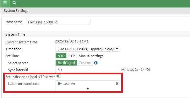

FortiGate verification steps: Verify local NTP server configuration. Ensure FortiGate is configured as a local NTP server for FortiSwitch:
Under GUI, go to System -> Settings -> Setup device as local NTP server (enable). Listen on Interfaces: Select the FortiLink interface.

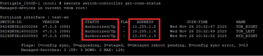

  • Check FortiSwitch connection status.
  • Verify the overall switch-controller connection.
execute switch-controller get-conn-status

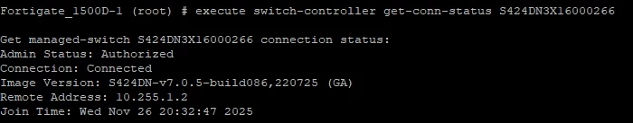

  • Verify the connection for a specific FortiSwitch:
execute switch-controller get-conn-status <FortiSwitch Serial Number>

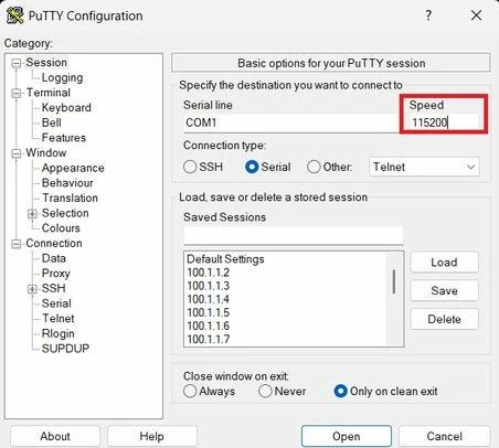

  • Accessing the FortiSwitch using the console. Connect using 115200 baud.

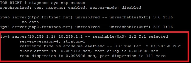

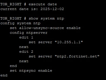

  • Verify NTP synchronization status:
diagnose sys ntp status
  • Verify system date/time & Check NTP configuration:
execute date
execute time
show system ntp

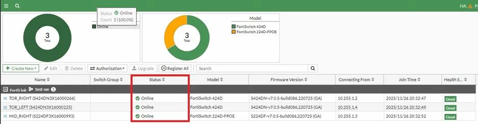

Expected Result:
If all verification steps above show no issues, the FortiSwitch status will appear as 'Online' under: WiFi & Switch Controller -> Managed FortiSwitches (the displayed status text may vary depending on the FortiOS version).
