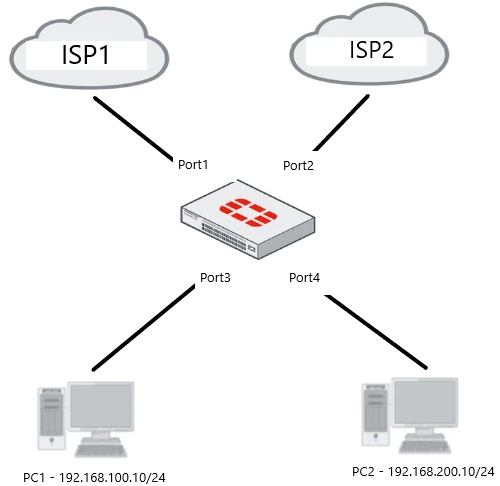

In the following diagram, FortiGate will route the traffic of PC1 to ISP1 and the traffic of PC2 to ISP2 using an SD-WAN input-device.

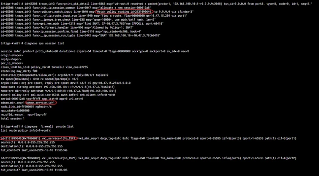

Verification for PC#1:

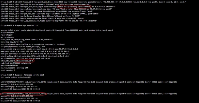

Verification for PC#2:
