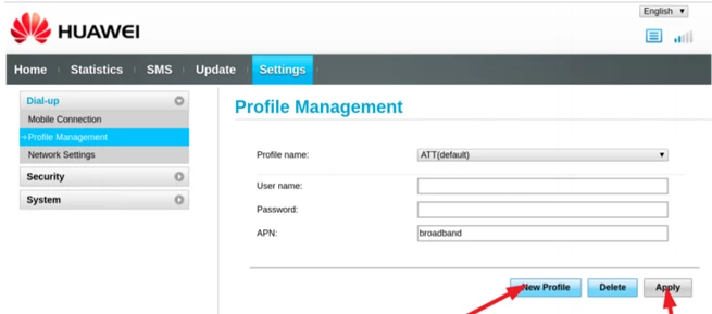

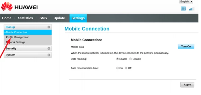

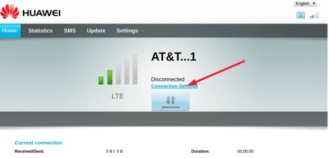

1) Access E3372 web interface from PC web browser at 192.168.x.1.
3) Create a new profile for the  carrier and select 'Apply'.
4) Go back to home and select the connect button.
5) Modem connected with internet and good to go!
