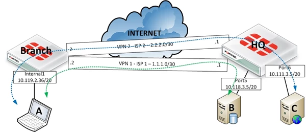

Diagram:
Expectations, and Requirements:
Scenario: HQ has 2 Internet connections called ISP1 and ISP2.
The branch has 1 Internet connection with 2 IPsec tunnels toward HQ ISP1 and HQ ISP2.
  • VPN 1 on ISP1: HQ Tunnel IP 1.1.1.1; Branch Tunnel IP 1.1.1.2.
  • VPN 2 on ISP2: HQ Tunnel IP 2.2.2.1; Branch Tunnel IP 2.2.2.2.
iBGP peering is configured on each VPN.
HQ routing logic :
The branch advertises its subnet with a BGP community:
10.119.0.0/20 → BGP Community 2:1.
HQ applies a route tag depending on the received BGP community:
BGP community 2:1 → route tag 21.
HQ will then apply SD-WAN rules based on the source address and route tag:
  • The route tag 21 and source 10.118.0.0/20 → VPN 1 as the primary path, VPN 2 as the secondary path.
  • The route tag 21 and source 10.111.0.0/20 → VPN 2 as the primary path, VPN 1 as the secondary path.
  • The routes without tag (Internet access) →  port1 as the primary path, port2 as the secondary path.
Branch routing logic :
HQ advertises each subnet with a unique BGP community:
10.118.0.0/20 -> BGP community 1:1.
10.111.0.0/20 -> BGP community 1:2.
The branch applies a route tag depending on the received BGP community:
BGP community 1:1 → route tag 11.
BGP community 1:2 → route tag 12.
The branch will then apply SD-WAN rules based on the route tag:
  • The route tag 11 → VPN 1 as the primary path, VPN 2 as the secondary path.
  • The route tag 12 → VPN 2 as the primary path, VPN 1 as the secondary path
  • The routes without tag (Internet through HQ) → VPN 1 & VPN 2 (default ECMP rule)
SD-WAN path selection is based on the configured SLA.

Received BGP networks are properly tagged:
FG300E-HQ # get router info bgp network 10.119.0.0
BGP routing table entry for 10.119.0.0/20
Paths: (2 available, best #1, table Default-IP-Routing-Table)
  Not advertised to any peer
  Local
    1.1.1.2 from 1.1.1.2 (10.119.2.36)
      Origin IGP metric 0, localpref 100, valid, internal, best
      Community: 2:1
      Last update: Mon Apr 16 09:50:35 2018
  Local
    2.2.2.2 from 2.2.2.2 (10.119.2.36)
      Community: 2:1
      Last update: Mon Apr 16 09:50:39 2018
BGP table version is 22, local router ID is 10.10.10.10
Status codes: s suppressed, d damped, h history, * valid, > best, i - internal,
              S Stale
Origin codes: i - IGP, e - EGP, ? - incomplete
   Network          Next Hop            Metric LocPrf Weight RouteTag Path
*> 10.111.0.0/20    0.0.0.0                       100  32768        0 i
*> 10.118.0.0/20    0.0.0.0                       100  32768        0 i
*>i10.119.0.0/20    1.1.1.2                  0    100      0       21 i
* i                 2.2.2.2                  0    100      0       21 i
Total number of prefixes 3
SD-WAN rules path selection:
FG300E-HQ # diag sys virtual-wan-link service
Service(4): Address Mode(IPV4) flags=0x0
  TOS(0x0/0x0), Protocol(0: 1->65535), Mode(sla)
  Members:
    1: Seq_num(3), alive, sla(0x1),cfg_order(0), selected
    2: Seq_num(4), alive, sla(0x1),cfg_order(1), selected
  Src address: 10.118.0.0-10.118.15.255
  Route tag address: 10.119.0.0/255.255.240.0
Service(3): Address Mode(IPV4) flags=0x0
  Members:
    1: Seq_num(4), alive, sla(0x1),cfg_order(0), selected
    2: Seq_num(3), alive, sla(0x1),cfg_order(1), selected
  Src address: 10.111.0.0-10.111.15.255
Service(2): Address Mode(IPV4) flags=0x0
  Members:
    1: Seq_num(1), alive, sla(0x1),cfg_order(0), selected
    2: Seq_num(2), alive, sla(0x1),cfg_order(1), selected
  Dst address: 0.0.0.0-255.255.255.255
FG300E-HQ # diagnose firewall proute list
list route policy info(vf=root):
id=4280680452 vwl_service=4(To_Branch_1) flags=0x0 tos=0x00 tos_mask=0x00 protocol=0 sport=0:65535 iif=0 dport=1-65535 oif=44 oif=45
source(1): 10.118.0.0-10.118.15.255
destination wildcard(1): 10.119.0.0/255.255.240.0
id=4280680451 vwl_service=3(To_Branch_2) flags=0x0 tos=0x00 tos_mask=0x00 protocol=0 sport=0:65535 iif=0 dport=1-65535 oif=45 oif=44
source(1): 10.111.0.0-10.111.15.255
id=4280680450 vwl_service=2(To_Internet) flags=0x0 tos=0x00 tos_mask=0x00 protocol=0 sport=0:65535 iif=0 dport=1-65535 oif=9 oif=10
destination(1): 0.0.0.0-255.255.255.255
source wildcard(1): 0.0.0.0/0.0.0.0
Branch:
FG60D-BR # get router info bgp network 10.118.0.0
BGP routing table entry for 10.118.0.0/20
  Local
    1.1.1.1 from 1.1.1.1 (10.10.10.10)
      Community: 1:1
      Last update: Mon Apr 16 09:21:17 2018
  Local
    2.2.2.1 from 2.2.2.1 (10.10.10.10)
      Community: 1:1
      Last update: Mon Apr 16 09:21:31 2018
FG60D-BR # get router info bgp network 10.111.0.0
BGP routing table entry for 10.111.0.0/20
  Local
      Community: 1:2
  Local
      Community: 1:2
BGP table version is 8, local router ID is 10.119.2.36
              S Stale
*>i10.111.0.0/20    1.1.1.1                  0    100      0       12 i
* i                 2.2.2.1                  0    100      0       12 i
*>i10.118.0.0/20    1.1.1.1                  0    100      0       11 i
* i                 2.2.2.1                  0    100      0       11 i
*> 10.119.0.0/20    0.0.0.0                       100  32768        0 i
FG60D-BR # diagnose sys virtual-wan-link service
  Members:
    1: Seq_num(2), alive, sla(0x1),cfg_order(0), selected
    2: Seq_num(1), alive, sla(0x1),cfg_order(1), selected
  Route tag address: 10.111.0.0/255.255.240.0
Service(1): Address Mode(IPV4) flags=0x0
  Members:
  Route tag address: 10.118.0.0/255.255.240.0
FG60D-BR # diagnose firewall proute list
id=4279697410 vwl_service=2(To_HQ_2) flags=0x0 tos=0x00 tos_mask=0x00 protocol=0 sport=0:65535 iif=0 dport=1-65535 oif=20 oif=19
destination wildcard(1): 10.111.0.0/255.255.240.0
id=4279697409 vwl_service=1(To_HQ_1) flags=0x0 tos=0x00 tos_mask=0x00 protocol=0 sport=0:65535 iif=0 dport=1-65535 oif=19 oif=20
destination wildcard(1): 10.118.0.0/255.255.240.0
