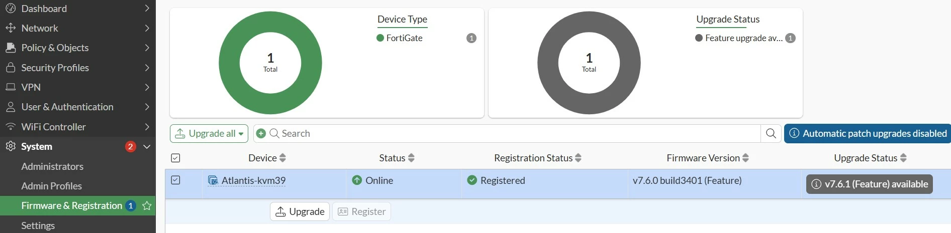

  2. Go to System -> Firmware and Registration, select the FortiGate, and then select the option Upgrade.

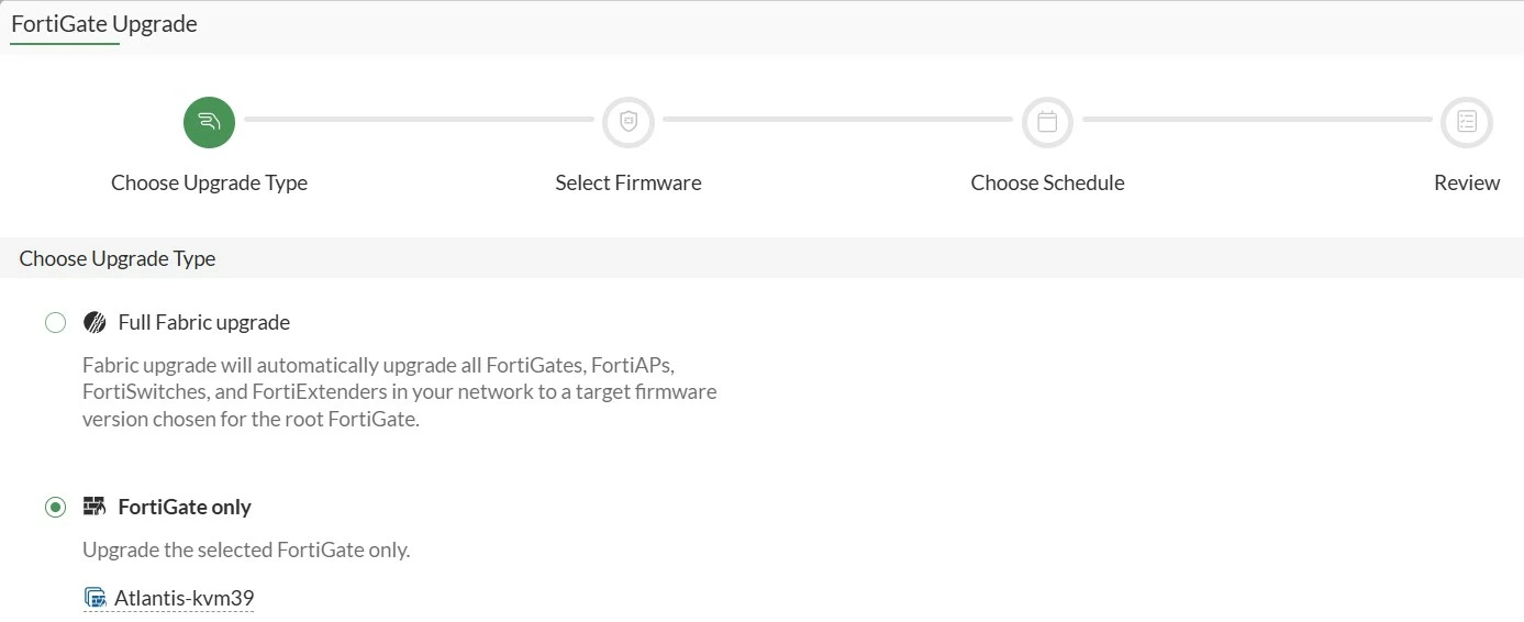

  1. Select Two Options will appear 'Full Fabric Upgrade' and 'FortiGate only', and select the appropriate option.
  1. In the example, 'FortiGate only' has been selected, and then select 'Next'.
Note: Even though the option reads 'FortiGate only – Upgrade the selected FortiGate only', selecting this option in an HA setup actually upgrades the FortiGate HA cluster, not just the individual unit.

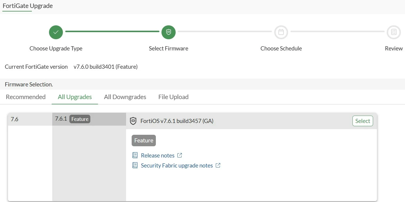

  1. At the Next window, Recommended, All Upgrades, All Downgrades, and File Upload.
  2. In the example, the 'All Upgrades' option has been selected.
  1. Select the 'Select' option and proceed to the next Section.

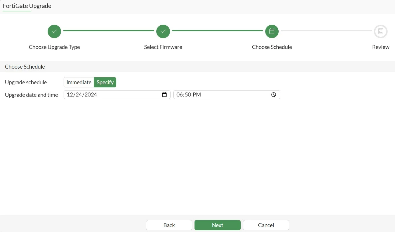

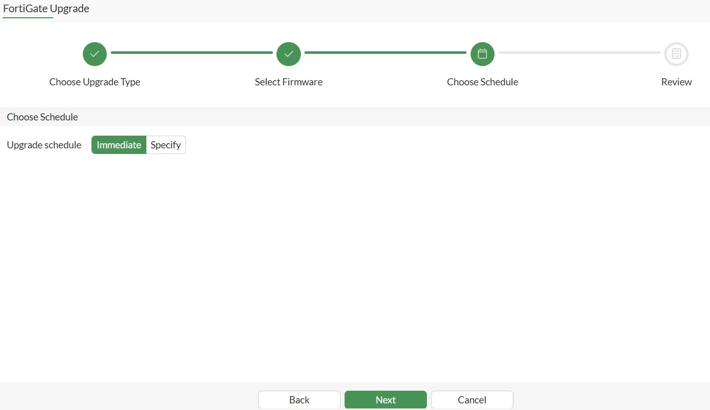

  2. In this section, select 'Immediate', or a scheduled update can be selected as well using the 'Specify' option.
  1. Choose 'Specify' if the upgrade needs to be performed automatically at a later time.

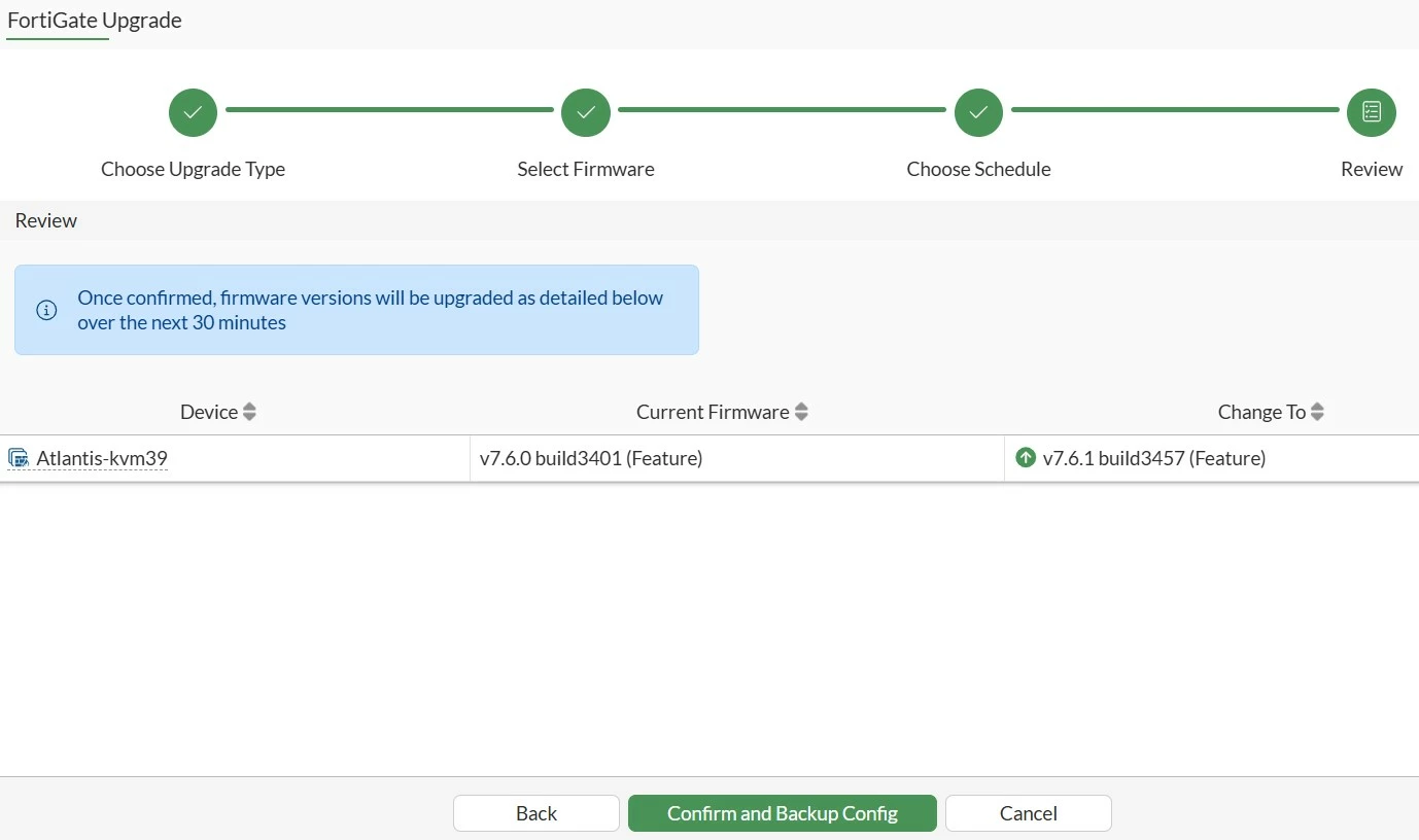

  1. Proceed to the 'Review' section, 'Confirm and Backup Config', and the Firewall will be upgraded to the target version.
