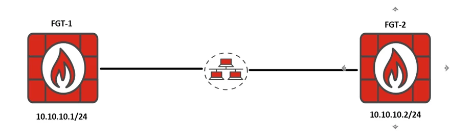

Topology:
10.10.10.1 -> Router id: 1.1.1.1.
10.10.10.2 -> Router id: 2.2.2.2.

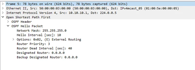

  • In the 'Init' state, the firewall has sent the OSPF 'hello' packet but has not received the 'hello' packet from the neighbor firewall.
  • Whenever a router/firewall sees its router ID in a neighbor hello packet, it confirms bidirectional communication and transitions the neighbor state to two-way.

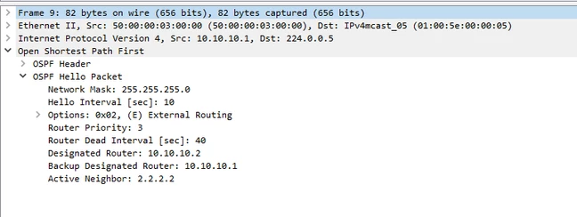

  • In the snippet above, when the neighboring firewall/router receives the OSPF hello from 10.10.10.1, it enters the init state. It will stay in the init state until it receives the following type of hello packet from 10.10.10.1:
  • In the above snippet, an active neighbor router-id is added and sent over a multicast address.
  • Once its neighbor 2.2.2.2 receives this hello packet, it will change the state from 'init' to a 2-way state.

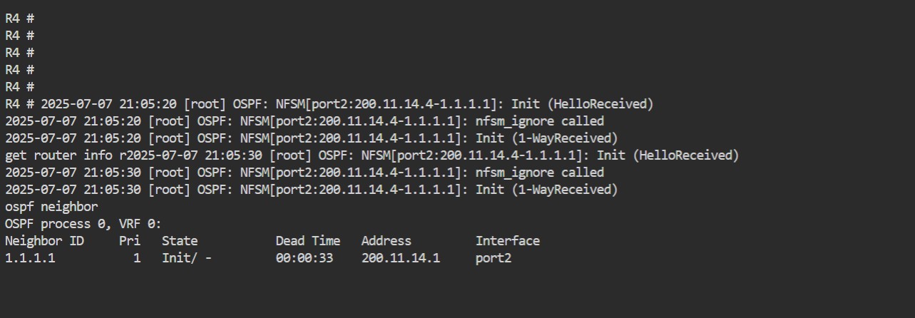

The log below shows what a stuck in Init state debug would look like.
Notice that the log only contains '(1-WayReceived)', there is no '(2-WayReceived).

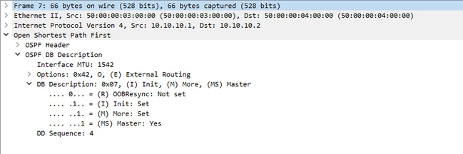

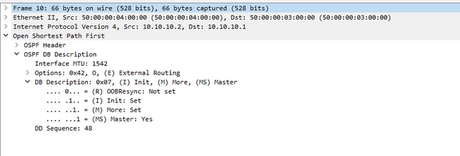

  • MTU needs to be matched; otherwise, the neighborship is stuck in the Exstart state.
Sometimes, MTU does match on both sides, but the neighborship remains stuck in the Exstart state because DBD/LSU packets are expiring and are unable to reach the other side.
This could be caused by an L2 switch or L2-WAN device (MPLS,) which is placed between OSPF routers and does not forward packets at this MTU.

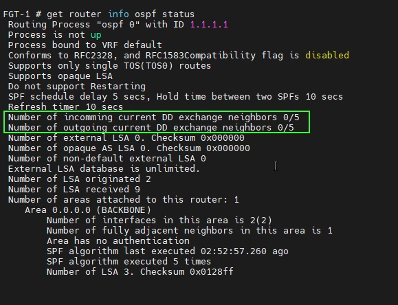

FortiGate can only send and receive 5 Database Descriptors (DD) packets at a given point of time in a queue for all interfaces trying to form a neighborship. If multiple OSPF interfaces are negotiating at the same time, it will take some time to form the neighborship between routers.
If OSPF interfaces are stuck in ExStart/Exchange state for some reason and the OSPF process queue is 5/5, then other OSPF interfaces will not be able to form neighbor-ship to 'Full' as well.
