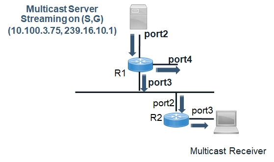

  • IGMP is configured on LHR (Last Hop Router) in this diagram R2.
  • PIM Dense Mode configured between R1 and R2.
  • Multicast source connected to R1.
Diagram:
FortiGate v6.4.
In the above diagram.
Multicast server having IP address 10.100.3.75 starts sending a multicast stream towards the group 239.16.10.1 through port2 of R1 (FHR):

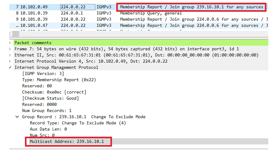

After some time, the Multicast receiver decides to join the group 239.16.10.1 so that it can receive the stream. Hence it will send an IGMP Join message towards R2.

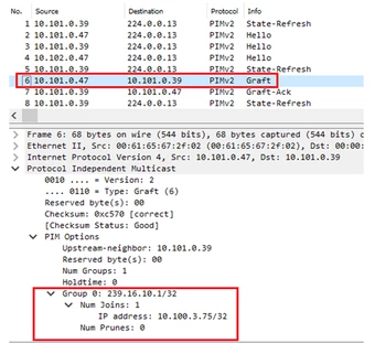

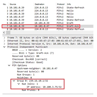

R2 having received the IGMP Join message, will update its IGMP group table and then send a PIM Graft message to the upstream R1 for this particular (S,G) entry. R1 will respond with Graft ACK.
R2 # get router info multicast igmp groups 239.16.10.1
IGMP Connected Group Membership
Group Address Interface Uptime Expires Last Reporter
239.16.10.1 port3 00:05:45 00:00:42 10.102.0.49
After R1 sends the Graft-ACK, R1 will update it is OLIST and start forwarding the multicast stream for (10.100.3.75, 239.16.10.1) through port3.

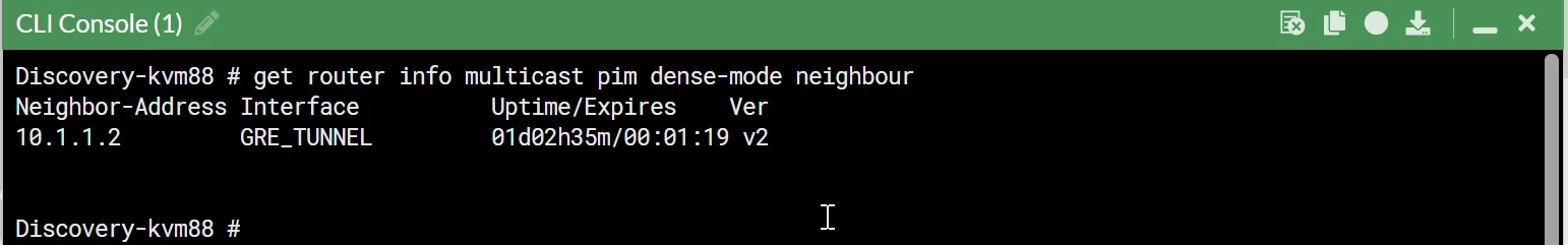

Command to see if neighborship is active or not:
For dense-mode:
 'get router info multicast pim dense-mode neighbour'.
Example:
