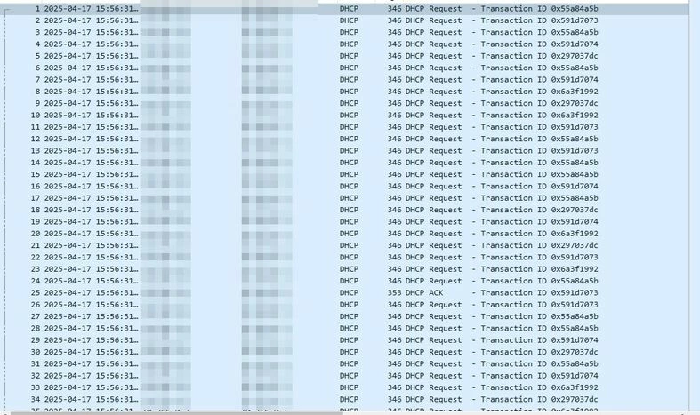

Or complete Packet capture can be taken from the GUI to see the complete DHCP process:
There is an unexpected number of DHCP requests coming from the internal subnet, which is causing the high CPU for the DHCP process.
To resolve it, verify the IP address sending the DHCP packets from the internal subnet, and an investigation needs to be done in the internal network, which is sending thousands of packets in milliseconds. Try shutting down that specific interface to bring the CPU down.
