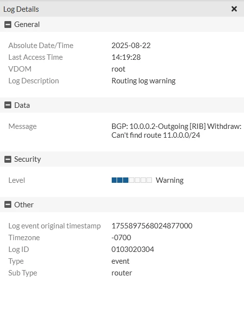

date=2025-09-16 time=15:17:11 eventtime=1758061030525342178 tz="-0700" logid="0103020304" type="event" subtype="router" level="warning" vd="root" logdesc="Routing log warning" msg="BGP: 10.0.0.2-Outgoing [RIB] Withdraw: Can't find route 11.0.0.0/24"
These messages occur when the remote BGP peer attempts to withdraw a route that was never installed in the RIB (Routing Information Base).

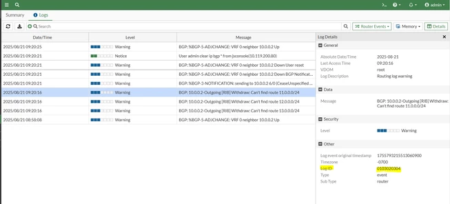

If the peer router advertises and updates many prefixes that are filtered out by a FortiGate prefix-list, this log is expected and can be repetitive. The logs can be viewed by going to Log & Report -> System Events -> Logs tab -> Router Events.

set filter "(logid 0103020304)”
set filter-type exclude
Note: log ID 0103020304 is a generic ID shared between multiple routing processes, so the provided filter will disable some other logs. For example, some Bidirectional Forwarding Detection (BFD) and Protocol Independent Multicast - Dense Mode (PIM-DM) events also use log ID 0103020304 and would not be recorded if the filter is applied. Before applying the filter, it is recommended to review available router event logs to ensure required logs will not be affected.
