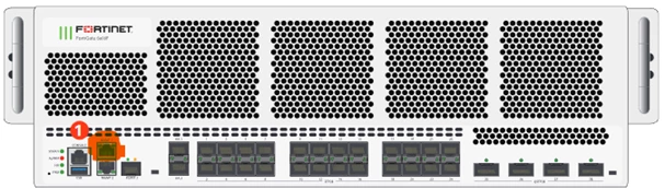

6000 series chassis
First, it is important to have the firmware that needs to be restored.
Secondly, set up the following IP address on the laptop NIC: @IP 192.168.1.10 Mask 255.255.255.0
Connect the laptop to the mgmt1 interface with an RJ45 cable.

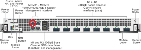

7000 series chassis
The whole chassis is replaced, FIMs and FPMs included:
Secondly, set up the following IP address on the laptop NIC: @IP 192.168.1.10 Mask 255.255.255.0.
