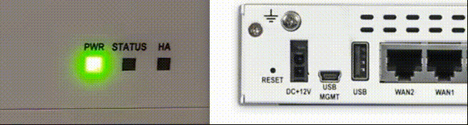

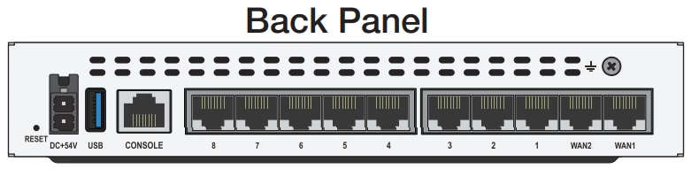

  • This button is labelled 'RESET' or 'BLE/RESET' (located either on the Back Panel near the power connector or on the Front Panel, like in 80F) and is enabled by default but usable only during the first 30 seconds after boot up. Successful use of this button will erase the current configuration.
  • Hard reboot the device (unplug, wait for at least 10 seconds, and plug it back online). In the first 30 to 60 seconds, wait until the 'status' light is blinking slowly, then press and hold the reset button until the 'status' light is blinking faster.

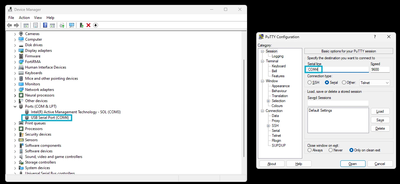

The FortiGate must be connected to a Desktop/Laptop via a Console Cable.
Go to Device Manager -> Ports (COM & LPT):
Verify that the same information from the Device Manager is being placed on the PuTTY configuration:

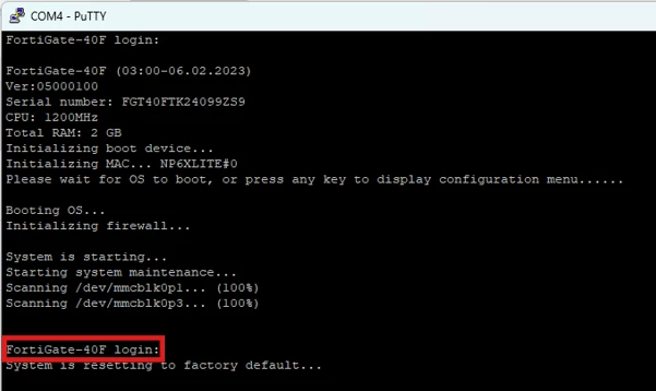

  • It can also be used as a reference that the login prompt on a Putty session is shown at the same time that the status light turns on:

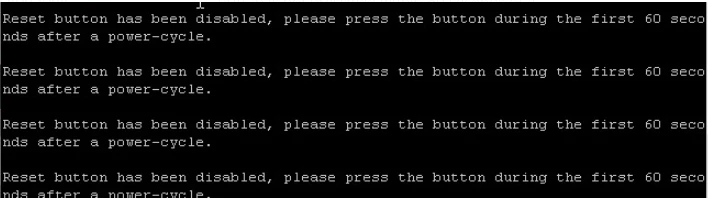

  • If the uptime of the unit is more than 30 or 60 seconds, the RESET button is disabled, and when pressed, the console output will prompt with the following message, and no action is taken if pressed at this stage.
  • A console cable can be connected and used to verify the reset process. After pressing the 'RESET' button, the following output can be seen on the CLI to confirm the device has been factory reset.

The reset button has been disabled. Press the button during the first 60 seconds after a power cycle.
