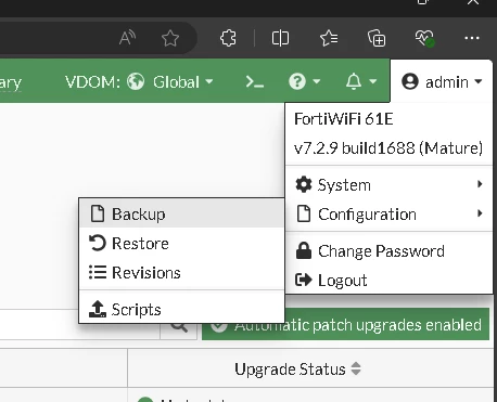

  1. Log in to the FortiGate GUI and backup the current configuration.

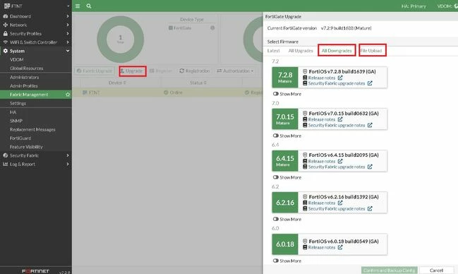

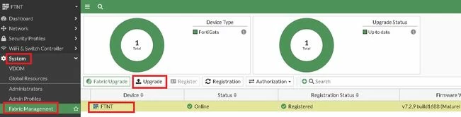

  2. Open System -> Fabric Management and select the FortiGate device.
  1. Select Upgrade and open the All Downgrades tab, then select the downgraded firmware. Alternatively, use File Upload and browse to the downloaded firmware.
  1. Once the firmware downgrade is complete, open admin>Configuration>Restore as shown in Step 1 but select Restore instead of Backup. Once the FortiGate completes the reboot, confirm the current firmware version using the following command:
