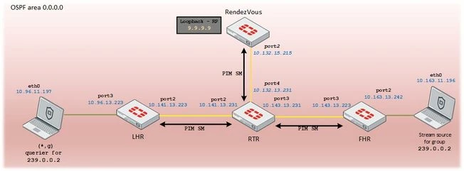

Diagram:
mcast-rp.pngObjective:
The querier will receive stream 239.0.0.2 thanks to the IGMP (*, G) report, PIM Sparse Mode, and Rendezvous Point.

  • The receiver does not know the source of the stream. It will send (*, G) IGMP report.
  • The source will register itself to the RP.
  • At first, the traffic will go to the shared tree.
  • 9.9.9.9 is the rendezvous point IP address.
PIM Spare Mode configuration:
PIM neighborship must be formed between the nodes as shown on network diagram.

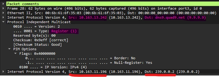

To verify that the register packet is sent to the RP IP 9.9.9.9, follow these steps:
  • Run the PCAP on the first hop router:
diagnose sniffer packet any 'host 9.9.9.9' 6 0 l
  • Start the stream for group 239.0.0.2.
  • Packet will flow toward the RP.
This packet capture could be translated to PCAP format and it will give something similar.
The source of the packet is the closest interface to the source having PIM enabled. The destination is then the RP IP address 9.9.9.9.
This is a PIM packet with the register flag on. Multicast flow 10.163.11.196 to 239.0.0.2 is encapsulated in this packet.
It will allow the RP to match the source with the group.
Consequently, this information is registered on the RP multicast table.
