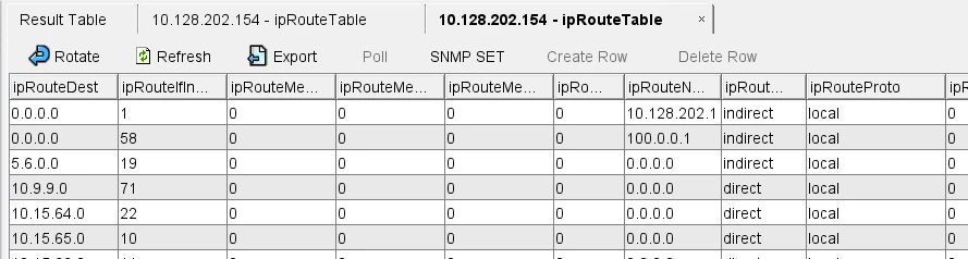

As an example, consider the following snmptable output using the OID .1.3.6.1.2.1.4.21 (ipRouteTable):
Note how the ipRouteProto section shows 'local' in this case for static and connected routes, though more options are supported including other(1), local(2), netmgmt(3), icmp(4), egp(5), ggp(6), hello(7), rip(8), is-is(9), es-is(10), ciscoIgrp(11), bbnSpfIgp(12), ospf(13), and bgp(14):

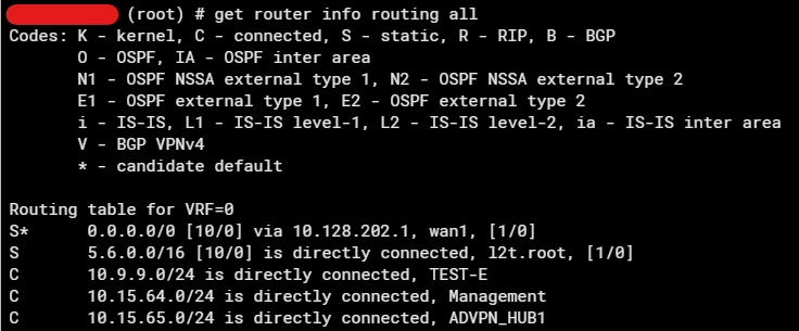

To compare against the routing table on FortiGate, run the CLI command get router info routing-table all:
