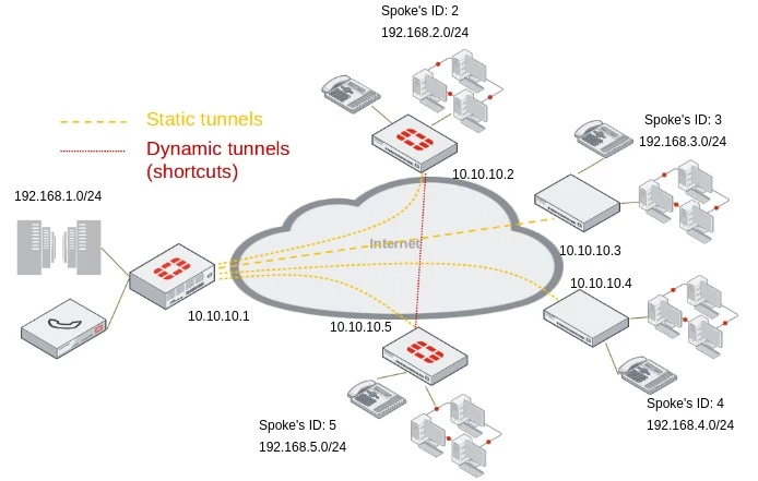

Diagram:
The same design as KB article “Technical Note: Fortinet Auto Discovery VPN (ADVPN)” is used.
In summary:
  • The Hub protects LAN subnet 192.168.1.0/24
  • The Hub’s overlay IP (i.e., its tunnel IP) is 10.10.10.1
  • Each Spoke protects a LAN subnet 192.168.x.0/24 where x is the Spoke’s ID (e.g., Spoke-02 protects subnet 192.168.2.0/24)
  • Each Spoke’s overlay IP is 10.10.10.x where x is the Spoke’s ID (e.g., Spoke-02 overlay IP is 10.10.10.2).
ADVPN-aware and non-ADVPN-aware spokes within the same ADVPN Hub-and-Spoke architecture:
