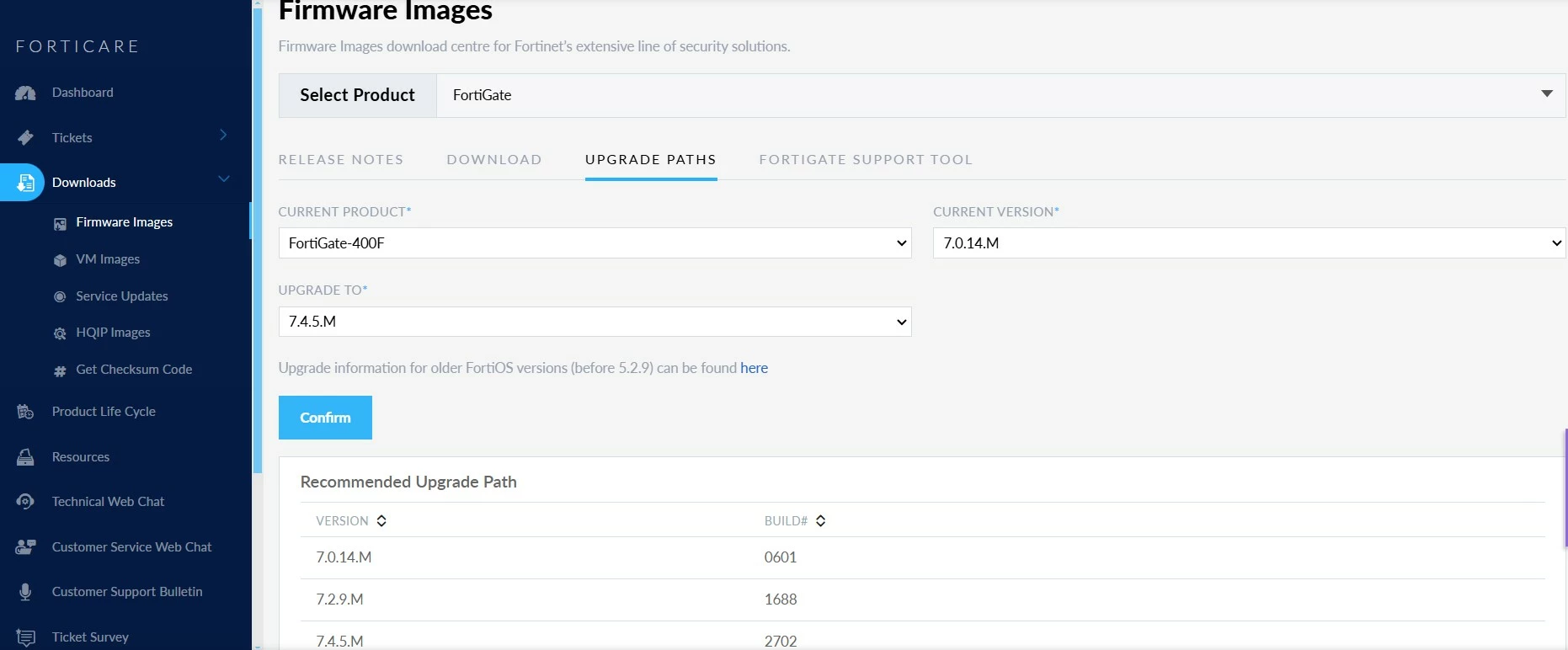

Physical presence should be maintained on site while doing the upgrade and the console cable should be kept handy. The upgrade path can be checked from the support.fortinet.com site. Log into support.fortinet.com -> Support -> Firmware Download -> Upgrade Path.

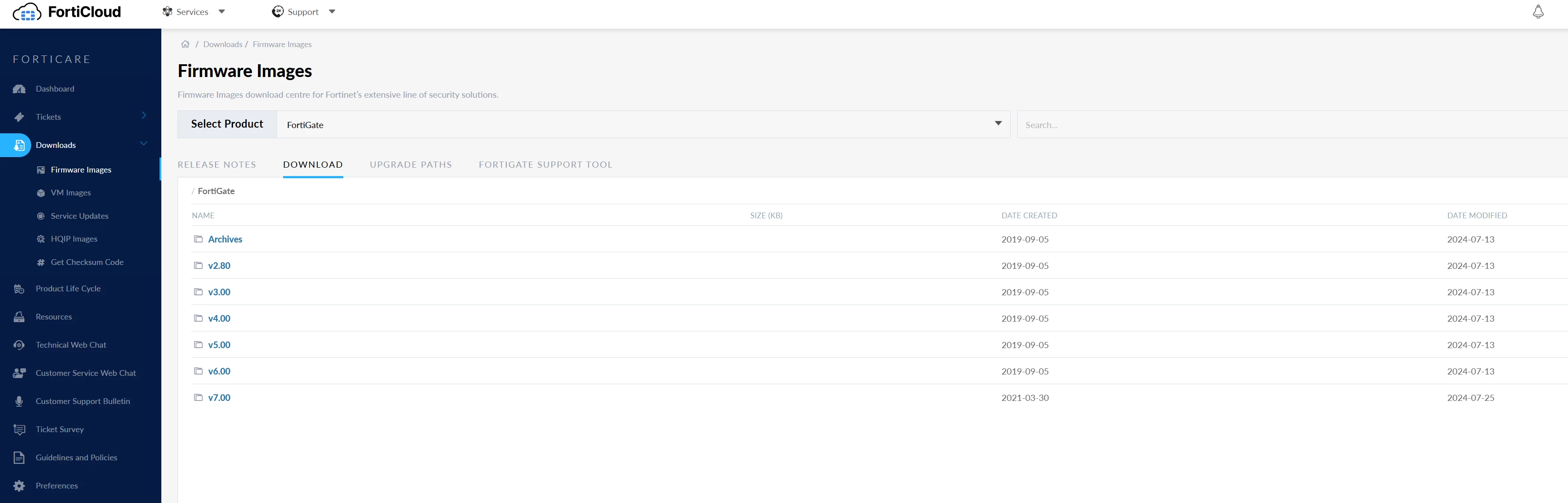

  • To download the image files navigate to support portalsupport.fortinet.com -> Support -> Firmware Download -> Download:
  • Navigate to the required firmware version and locate the image file as the below example.

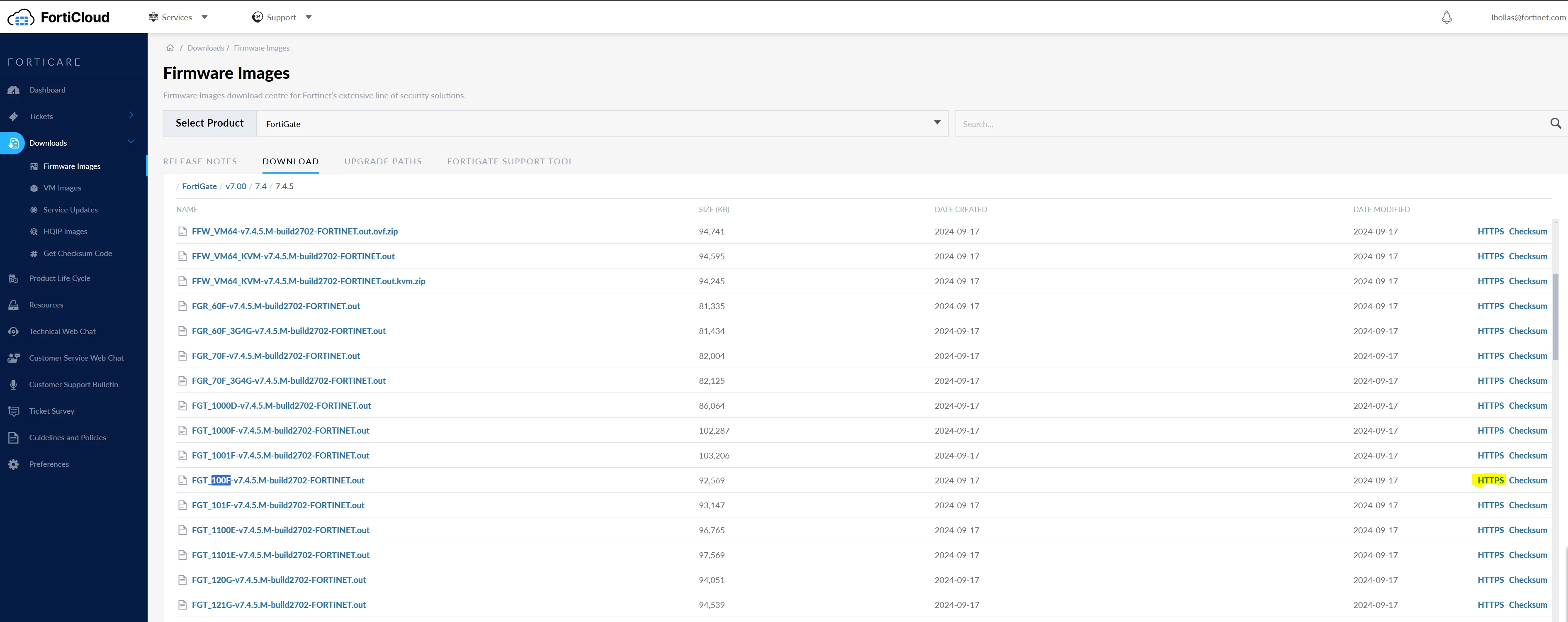

Example: FortiGate 100F.
  • The file name starts with -> FGT_100F.
  • Select 'HTTPS' to start the download.

Note: 'pop-ups' must be allowed by the web browser for the 'HTTPS' button to work.

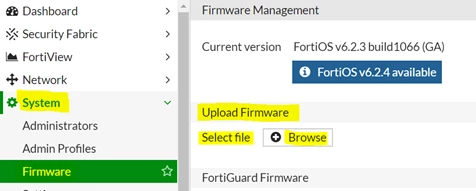

  • Select System -> Firmware and select the 'Browse' button to locate the firmware image file.
  • Locate the file on the local computer and select the firmware image file.

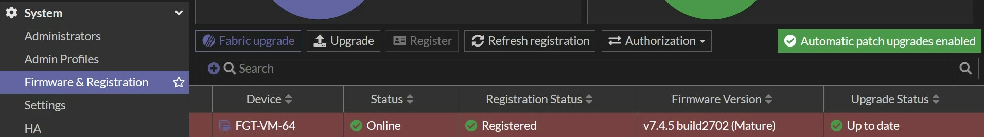

  • In the GUI, select System -> Firmware and Registration.
  • If the FortiGate is the Root FortiGate at the Fabric then the 'Upgrade' option needs to be selected.

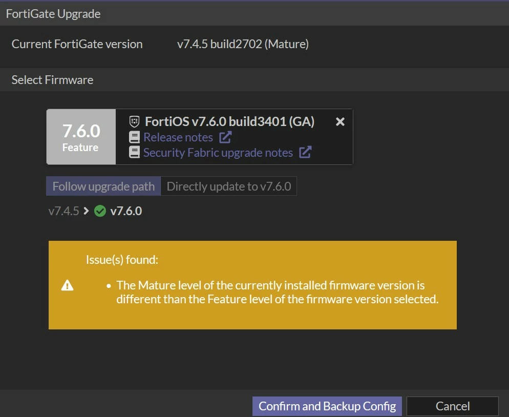

  • Then 'Confirm and Backup Config' is selected, this option will download the Firmware automatically from the FortiGuard Server and the new Firmware will be installed.
The Firewall will reboot during the Firmware Upgrade Process.
