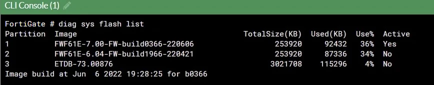

  1. Determine the Image revision ID on flash using the command:
diagnose system flash list

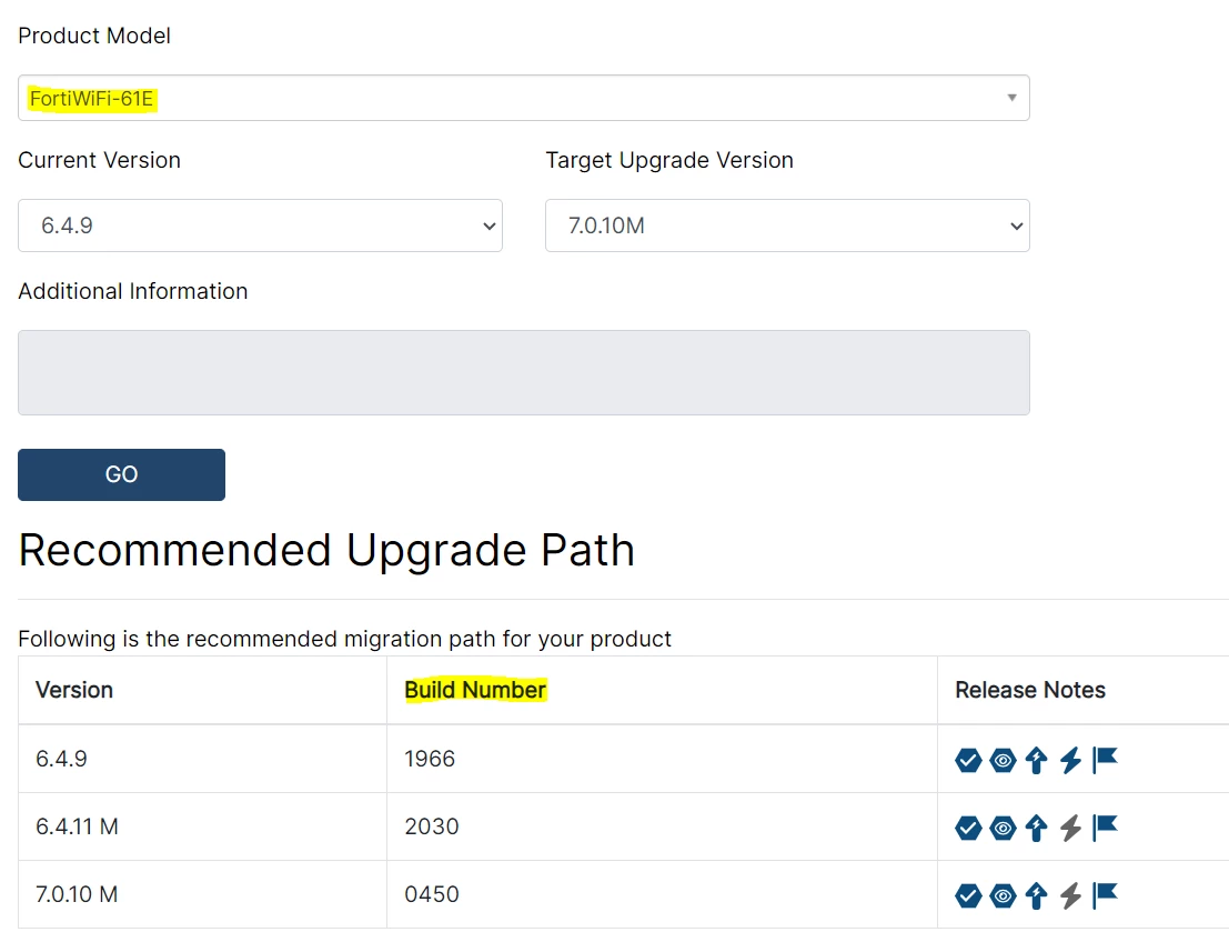

Use the build number to determine the precise firmware version and compare it to support.fortinet.com or the upgrade tool, which allows one to confirm which build number corresponds to the firmware version.

  1.  Use the following command to restore the firmware held in partition 2:
The device will reboot and load the previously selected version.
