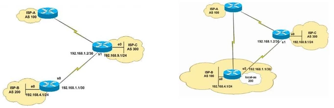

The neighbor local-as command is a useful command when doing AS  migration or merging (acquisition of a network that belongs to a different AS) transition period still uses the old AS, defined as the local AS.
Refer to the example below:
The Router, which was a member of AS 200, has been migrated to the new AS 100. In this case, the local-as command will be used.
