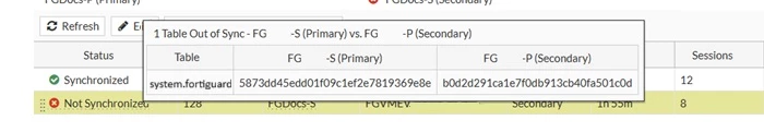

Description This article describes how to fix a high availability out-of-sync issue, which can be caused by a configuration mismatch in the FortiGuard settings.
Scope FortiGate.
  1. Review the FortiGuard configuration of both appliances:
show system fortiguard

  1. After comparing the configurations, manually set the recommended configuration provided by this KB article: Troubleshooting Tip: Unable to connect to FortiGuard servers.
config system fortiguard
    set fortiguard-anycast disable
    set protocol udp
    set port 8888
    set sdns-server-ip 208.91.112.220 173.243.140.53 210.7.96.53 200.91.112.220
The configuration must be manually applied in both appliances over the CLI console.
  1. Recalculate the checksum over the CLI console in the Primary unit:
diagnose sys ha checksum recalculate
  1. After recalculating, confirm the cluster checksum:
diagnose sys ha checksum cluster
