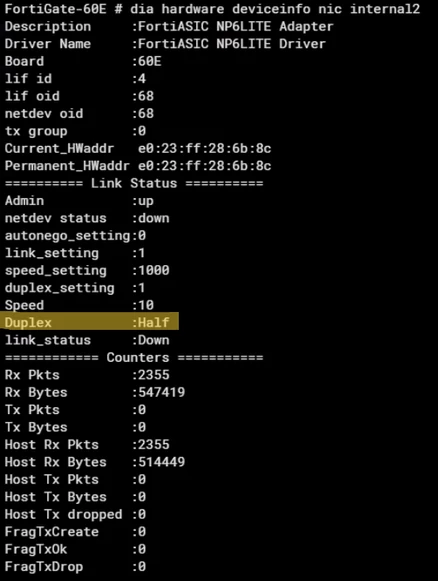

Whenever a port runs at whichever speed and full duplex,  FortiGate can be reloaded under any circumstance or simply bounced. But the port comes back on in half-duplex, as can be seen in the image below by using the following diagnose command:
diagnose hardware deviceinfo nic <desired port>
For example, in this case:
diagnose hardware deviceinfo nic internal2
If this happens, a simple bounce or configure port in full-duplex won't be enough; hence, to fix this, follow up below steps:

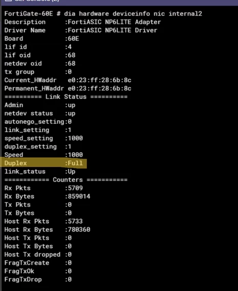

After executing the above steps, the port will come up with full duplex as in the image below:
