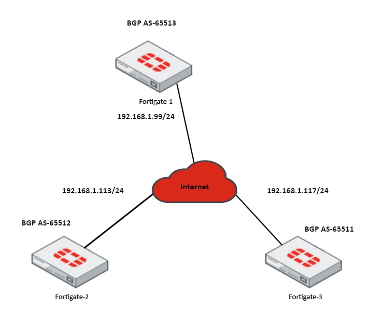

In FortiOS 7.4.4 and 7.6.0 is introduced a new feature which allows assignment of multiple remote Autonomous Systems (AS) to a signle BGP neighbor group. This can be done with using the AS path lists. This feature offers increased flexibility in managing BGP configurations.
BGP configuration of FortiGate-1:

FortiGate-2 BGP configuration:
config router bgp
    set as 65512
    set router-id 3.3.3.3
    config neighbor
        edit "192.168.1.99"
           set remote-as 65513
    config network
              set prefix 192.168.200.0 255.255.255.0
FortiGate-3 BGP configuration:
config router bgp
    set as 65513
    set router-id 2.2.2.2
    config neighbor
        edit "192.168.1.99"
             set remote-as 65513
    config network
         set prefix 192.168.201.0 255.255.255.0
For simplicity, FortiGate-2 will advertise network 192.168.200.0/24, and FortiGate-3 will advertise network 192.168.201.0/24. FortiGate-1 will filter based on the AS-filter using the new introduced commands below. In the provided example, the regular expression '^6551[2-3]$' is used, which allows only AS 6551* , where * varies between 2 and 3. This range can be extended or modified based on the needs.

If the AS of FortiGate-2 is changed to 65514, for example, then FortiGate-1 will have only one BGP session, because AS 65514 does not match the configured regex for aspath-list.
