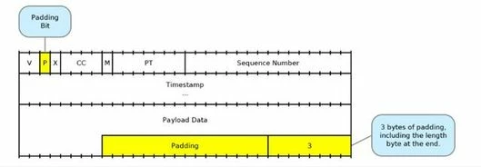

Padding in RTP packets operates according to the specifications in RFC 3550. The RTP header includes a padding bit that, when set to 1, indicates the use of padding. Padding entails the addition of extra bytes at the end of an RTP packet that do not contribute to the payload. These bytes are placed immediately after the payload data, with the final byte specifying the number of padding bytes added.
In the absence of padding, the payload size is inferred from the total packet length minus the header. When padding is present, the exact number of padding bytes must be known to determine the actual payload size.

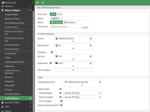

  2. Configure traffic shaping:
    Enables control over packet characteristics such as size and transmission speed. Configuration of the shaper ensures that voice packets maintain a minimum size and a consistent transmission rate. This shaping policy is applied to the previously defined firewall rule that governs traffic originating from the PBX or server under padding test conditions, directed toward the LAN behind the FortiGate device.

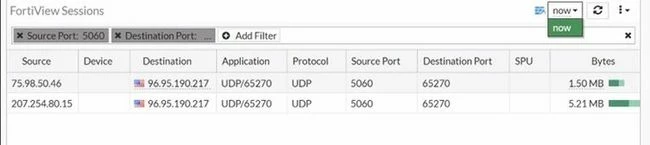

  4. Monitor performance:

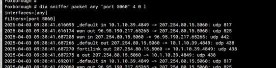

    It is essential to verify the effectiveness of the configuration and the proper execution of the padding test. FortiView Sessions can be utilized to identify source and destination traffic and to confirm that the traffic shaper is functioning as intended.
diagnose sniffer packet any "port 5060" 4 0 l

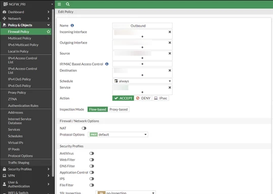

 Example configuration on a FortiGate on CLI:
config firewall policy   <-- Define policy.
        set srcintf "port1"     <-- Source interface.
        set dstintf "port2"     <-- Dst interface.
        set srcaddr "all"       <-- Source IP address.
        set dstaddr "all"       <-- Dst IP address.
        set service "SIP" "RTP"        <-- VoIP protocols.
        set logtraffic all             <-- Enable register.
        set profile-protocol-options "SIP"     <-- Enable inspection SIP or RDP, etc.
        set ssl-ssh-profile "certificate-inspection"    <-- Enable SSL/SSH inspection.
        set av-profile "default"                        <-- Enable Antivirus profile.
        set webfilter-profile "default"                 <-- Enable Web Filter.
        set application-list "default"                  <-- Enable list applications.
        set traffic-shaper "voice_shaper"               <-- Model traffic.
        set nat enable                                  <-- Enable NAT.
