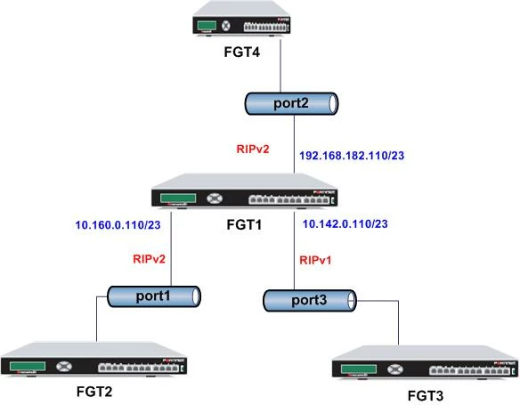

Diagram
This article is based on the following diagram. The configuration will be given for FGT1.
Expectations, Requirements
- The goal is to enable RIP on all 3 interfaces of FGT1: port1, port2, and port3.
- On port3 however, we want to run RIP1.
- No other subnets should be advertised by RIP (that is: no static route, no routes from BGP, OSPF..)

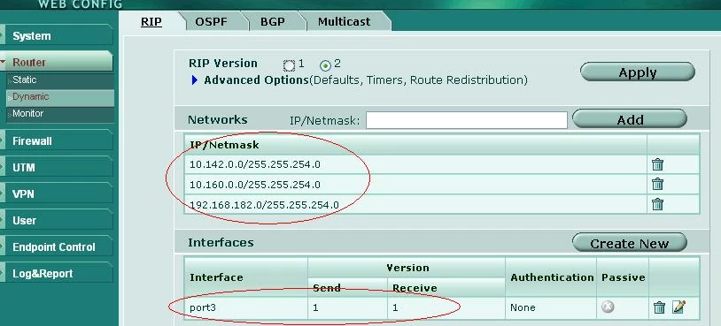

CLI configuration of FGT1 :
# config router rip
        config interface
            edit "port3"
                set receive-version 1
                set send-version 1
        config network
                set prefix 10.142.0.0 255.255.254.0
                set prefix 10.160.0.0 255.255.254.0
            edit 3
                set prefix 192.168.182.0 255.255.254.0
        config redistribute "connected"
        config redistribute "static"
        config redistribute "ospf"
        config redistribute "bgp"
Note 1: In order to enable RIP on multiple interfaces at once, set a larger mask in the network prefix. Example : a prefix of 10.0.0.0/8 will enable RIP on ALL interfaces for which the subnets are in this range.

GUI configuration of FGT1 :

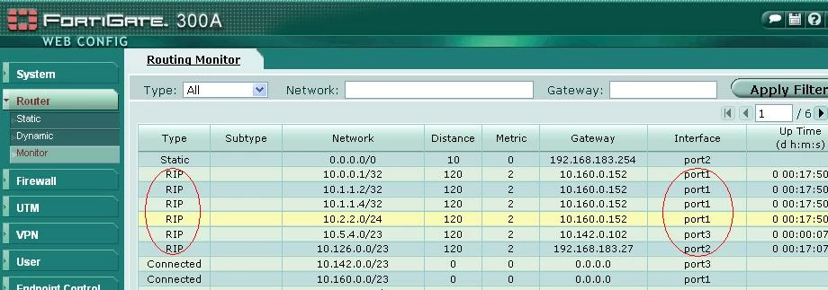

Also, check from the GUI if routes are received; in the example, below there are RIP routes received on port1, port2 and port3.
