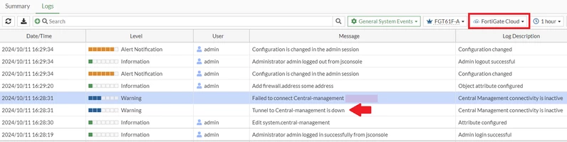

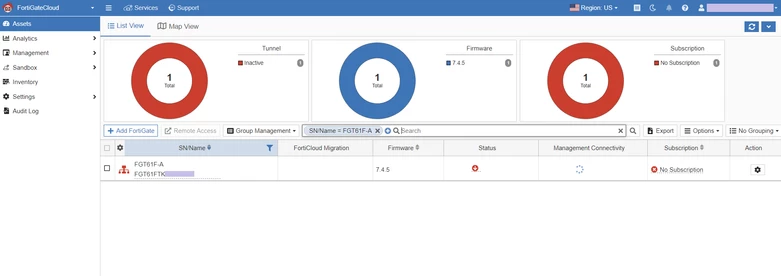

Effect of disabling central-management:
While the management tunnel is disabled in this way, FortiGate will show as offline in FortiGate Cloud, and it is no longer possible to monitor or manage the FortiGate remotely from the FortiGate Cloud portal.

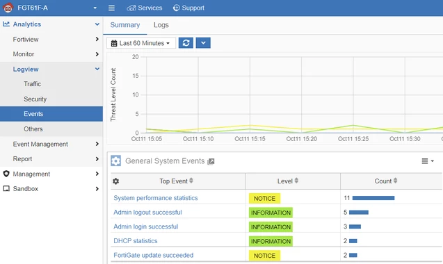

FortiGate will still send logs to FortiGate Cloud as long as it is running the latest GA patch of its firmware release.

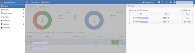

When the management tunnel is enabled, a High Availability cluster managed by FortiGate Cloud shows only the primary as Online:
The secondary device will always show offline even if the management tunnel is enabled in FortiGate Cloud.
In this scenario, the management tunnel to FortiGate Cloud has not yet been disabled even though the secondary device shows offline.
