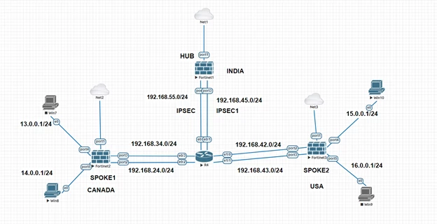

This article describes how to deny advertising BGP routes with a next hop that does not belong to the tunnel itself.
The concept is to avoid routing traffic over the wrong tunnel.
Each hub and spoke is using two internet circuits consisting of 2 Overlays configured in the scenario below.
Naming Convention used on HUB:
ADVPN1 is referred to as IPSEC.
ADVPN2 is referred to as IPSEC1.
Naming Convention used on Spoke1:
IPSEC1: Primary Tunnel.
IPSEC2: Secondary Tunnel.
Naming Convention used on Spoke2:
For example, in this case, the ADVPN-1 overlay subnet is 10.10.1.0/24, and wanted to advertise routes over the ADVPN-1 tunnel with next hops in the same subnet, only 10.10.1.0/24.
The IPSEC overlay is using the 10.10.1.0/24 subnet, and the IPSEC1 overlay is using the 10.10.2.0/24.
Two routes will be put in the routing table using the commands ibgp-multipath enable and additional-path enable under the config router BGP on the hub and spokes, and using the command additional-path both, both routes will also be broadcast.
To be more specific hub should have additional-path sent, and the spokes should have additional-path received.
Suppose the subnet 14.0.0.0/24 Behind the Spoke 1 wants to talk to 15.0.0.0/24 behind Spoke 2. When examining the spoke1's routing table, it is possible to observe that two copies are being received, as shown below.
Upon checking from the spoke2 and attempting to see the subnet 14.0.0.0/24 that is behind the spoke1, the same thing will occur, and this will result in problems.
