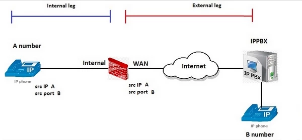

A voice call has two legs, when  troubleshooting it is recommended to analyze each leg.
In this way it is possible to identify if there are voice problems in the  internal or external FortiGate network.

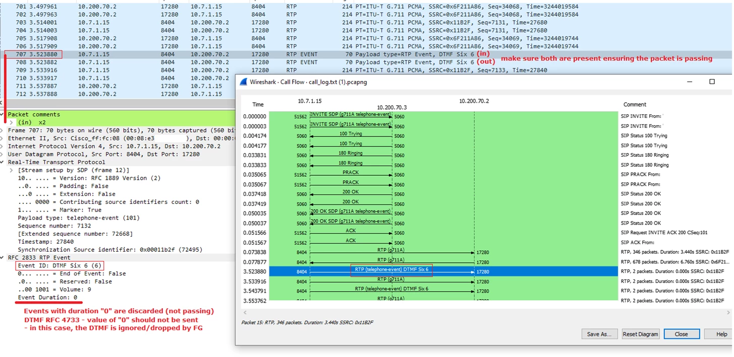

DTMF tones that use in-band method are based on standard RFC 2833, signals are encapsulated into RTP packets using a Payload Type.
These packets can be found by filtering in Wireshark by protocol 'RTP event'.
Usually if packet capture was using interface 'any' in sniffer, two packets will be shown, the first of them is from endpoint to internal interface (LAN) and the second packet is from the external interface (WAN) to SIP proxy.
It is possible to see in this capture that the DTMF code is sent as 'RTP EVENT' and using the same ports as the regular audio traffic (RTP):
Troubleshooting.
In the example there are two packets, first packet means that DTMF tone is coming to FortiGate from endpoint to internal interface and second is the same packet now from external to PBX (NAT IP will be shown as source).
Open RTP packet to check what Payload Type was negotiated for both sides (it is not always the same, it depends upon the negotiation of far-end SIP units).
With this capture, confirm and validate that the DTMF packet is passing through the FortiGate correctly (same content), then if the DTMF tones are not recognized, check in the SIP endpoints that:
1) In-band method (RFC 2833/4733) is supported by both sides (SIP endpoints).
2) RFC 2833/4733 is compliant in both sides (SIP endpoints).
3) Payload type is using the same for both sides (SIP endpoints).
Remember that DTMF tones are encapsulated into RTP packets, then if the call has voice in both sides (RTP) then DTMF should pass in the same channel (source/destination port).
The purpose of this procedure is only to show these packets.
FortiGate cannot do any action over these packets, the DTMF tones are treated as RTP events in a call.
In other words, if a voice call is passing and audible both ways, the DTMF codes should also pass.
