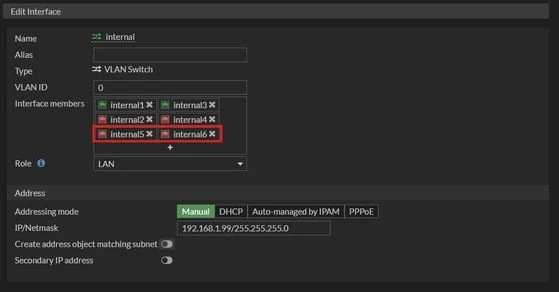

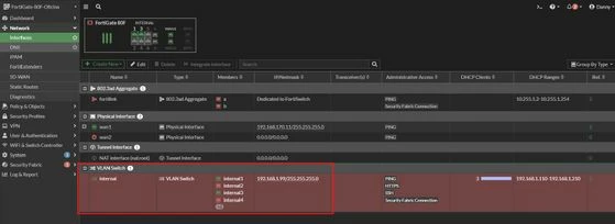

If the physical interfaces are members of a Hardware/Software/VLAN Switch, remove the desired ones from it:

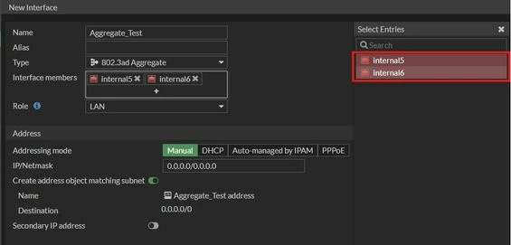

Set the type to '802.3ad aggregate' and add the members to it:
