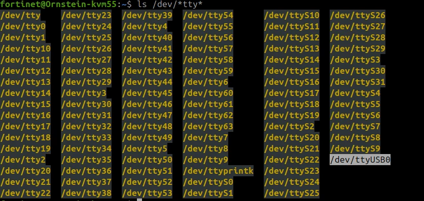

For a USB console cable, this can be usually done by running the following command in the terminal: ls /dev/*tty*.
In the following screenshot, the USB serial cable is located at /dev/ttyUSB0.
If using a serial port built into the PC, generally it is a device under /dev/ttySx.
Many serial devices may be visible depending on the specific hardware in the PC.
In order to figure out which one should actually be used, generally this will show up under dmesg. In this case, it is /dev/ttyS0.
Run the following command to see this info: sudo dmesg | grep tty.
