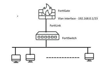

Network connectivity:
To block intra-VLAN traffic by aggregating traffic using the FortiGate unit. This prevents direct client-to-client traffic visibility at the layer-2 VLAN layer. Clients can only communicate with the FortiGate unit. After the client traffic reaches the FortiGate unit, the FortiGate unit can then determine whether to allow various levels of access to the client by shifting the client's network VLAN as appropriate, if allowed by a firewall policy, and proxy ARP is enabled.
To block intra-VLAN traffic using the FortiGate GUI, navigate to WiFi & Switch Controller -> FortiSwitch VLANs -> toggle 'Block intra-VLAN traffic'.

Once 'Block intra-VLAN traffic' is enabled on a given VLAN, the maximum IP range the FortiOS-based Proxy ARP feature can proxy is 256, i.e., /24 per table entry.
For an environment where a VLAN/subnet is bigger than a /24(255.255.255.0), it is possible to define multiple proxy-arp ranges and apply them to the same interface as seen below:
