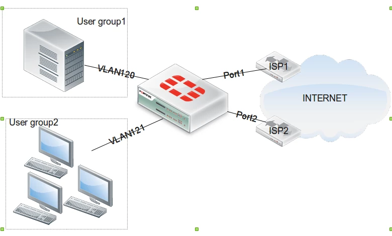

A solution is to create a separate VDOM, containing the explicit proxy. This VDOM will handle the HTTP traffic, and route this traffic to the "root" VDOM.
FortiGate.
Diagram:
Expectations, Requirements
Expectations :
  • User group 2 HTTP traffic should use Fortigate explicit proxy. For this traffic, the explicit proxy should use port2 to reach the internet.
  • User group 2 non-HTTP traffic goes directly to the internet using port1
  • User group 1 all traffic goes through the default route on port1
It is supposed that you have already setup a dual-wan configuration, with port1 as primary interface, and port2 as a "secondary" interface, that will be used to handle the HTTP traffic from the web-proxy.
