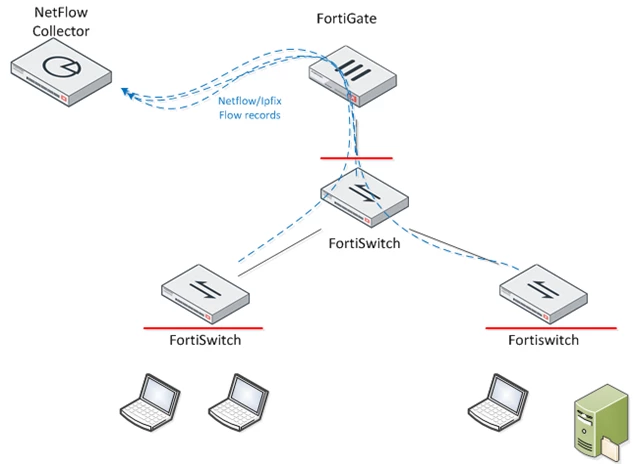

This article explains how to configure Netflow/IPFIX for managed FortiSwitch on the switch controller.
Configure flow-tracking related parameters by using the default values:

The following are the sampling mode options:
- Perimeter sampling: RX sampling is enabled on all non-fabric FortiSwitch ports, including the access port and FortiLink port, but not the FortiLink ISL port.
- Device-Ingress sampling: RX sampling is enabled on all FortiSwitch ports.
- Local sampling: Sampling must be enabled on specific FortiSwitch ports by using config switch-controller managed-switch and config ports.
