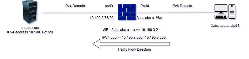

Topology:

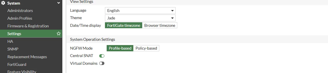

  1. Enable Central SNAT by navigating to System -> Settings -> System Operation Settings -> Enable Central SNAT.

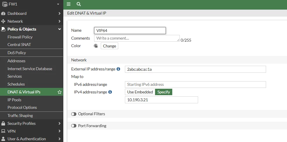

  1. Configure an IPv6 VIP; the external IPv6 address must be different from the interface address configured. To configure, navigate to DNAT & Virtual IPs -> IPv6 Virtual IP and select  'Create New'.
CLI:
config firewall vip6
    edit "VIP64"
        set uuid 827245da-5c92-51f0-93ca-1ea303e3c75b
        set extip 2abc:abc:a::1a
        set nat66 disable
        set nat64 enable
        set ipv4-mappedip 10.190.3.21

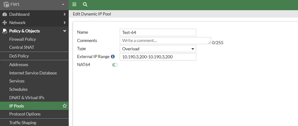

  1. Create an IP pool with an IP address that is not the same as the interface IP or not used anywhere else on the network. The 'arp reply' should be enabled for this address.
CLI:
config firewall ippool
    edit "Test-64"
        set startip 10.190.3.200
        set endip 10.190.3.200
                 set arp-reply enable
        set nat64 enable

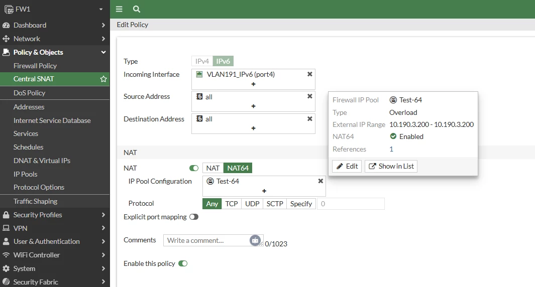

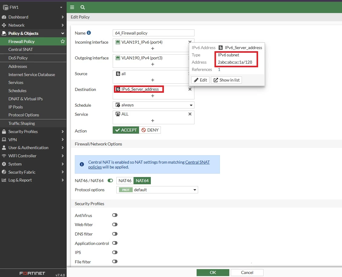

  1. Configure a Central NAT policy to translate the IPv6 address to the IPv4 address pool, and then configure a firewall policy to allow NAT64 Traffic.
When Central NAT is enabled, the user cannot add a VIP object as a destination address in the firewall policy. Hence, it is recommended to use the actual mapped address, i.e., 2abc:abc:a::1a.
