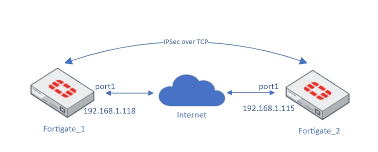

Sometimes, IKE/ESP packets are blocked between FortiGate and remote IPSec peers, which is used to encapsulate IKE and ESP packets into UDP 4500. In some situations, UDP 4500 could be also blocked, v7.4.4 has introduced a new feature that supports RFC 8229. With this RFC, FortiGate encapsulates the IKE/ESP packets into TCP 4500.
This RFC implementation needs to be supported and must be pre-configured on both ends to work. This option is valid only for IKEv2.
Topology:
