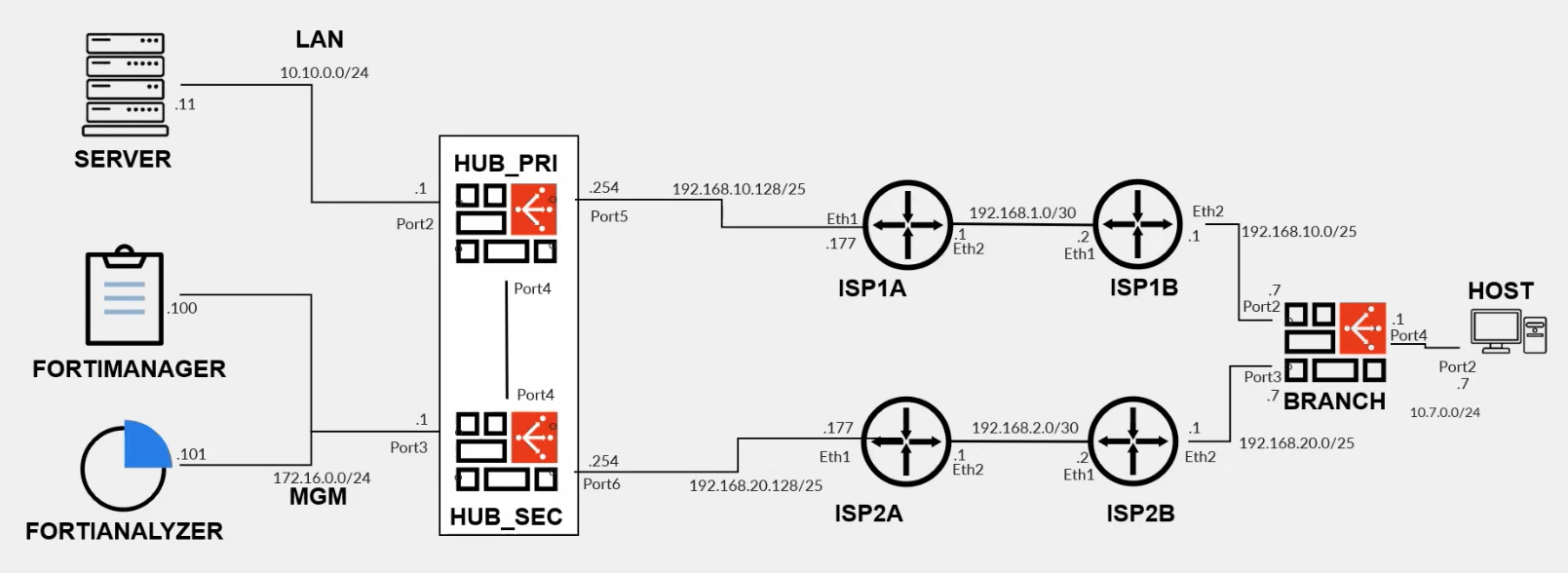

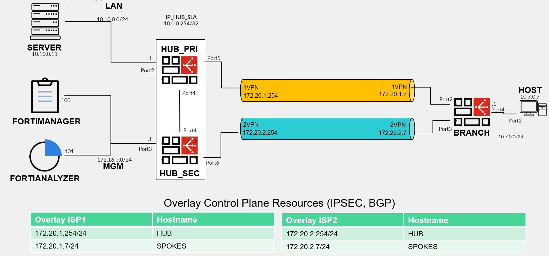

Layer 3 Topology:
SD-WAN Topology:

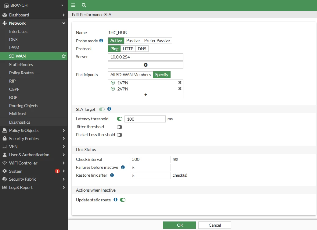

Create a configuration of the Performance SLA.
CLI:
config system sdwan
    config health-check
        edit "1HC_HUB"
            set server "10.0.0.254"
            set members 3 4
                config sla
                        set link-cost-factor latency
                        set latency-threshold 100
GUI: Go to Network -> SD-WAN -> Performance SLAs -> Create New.
Note: If enabled, the update-static-route will remove static routes associated with interfaces used in the SD-WAN health check only if those interfaces fail their health check. If it is out-of-SLA, the routes will remain in the routing table.

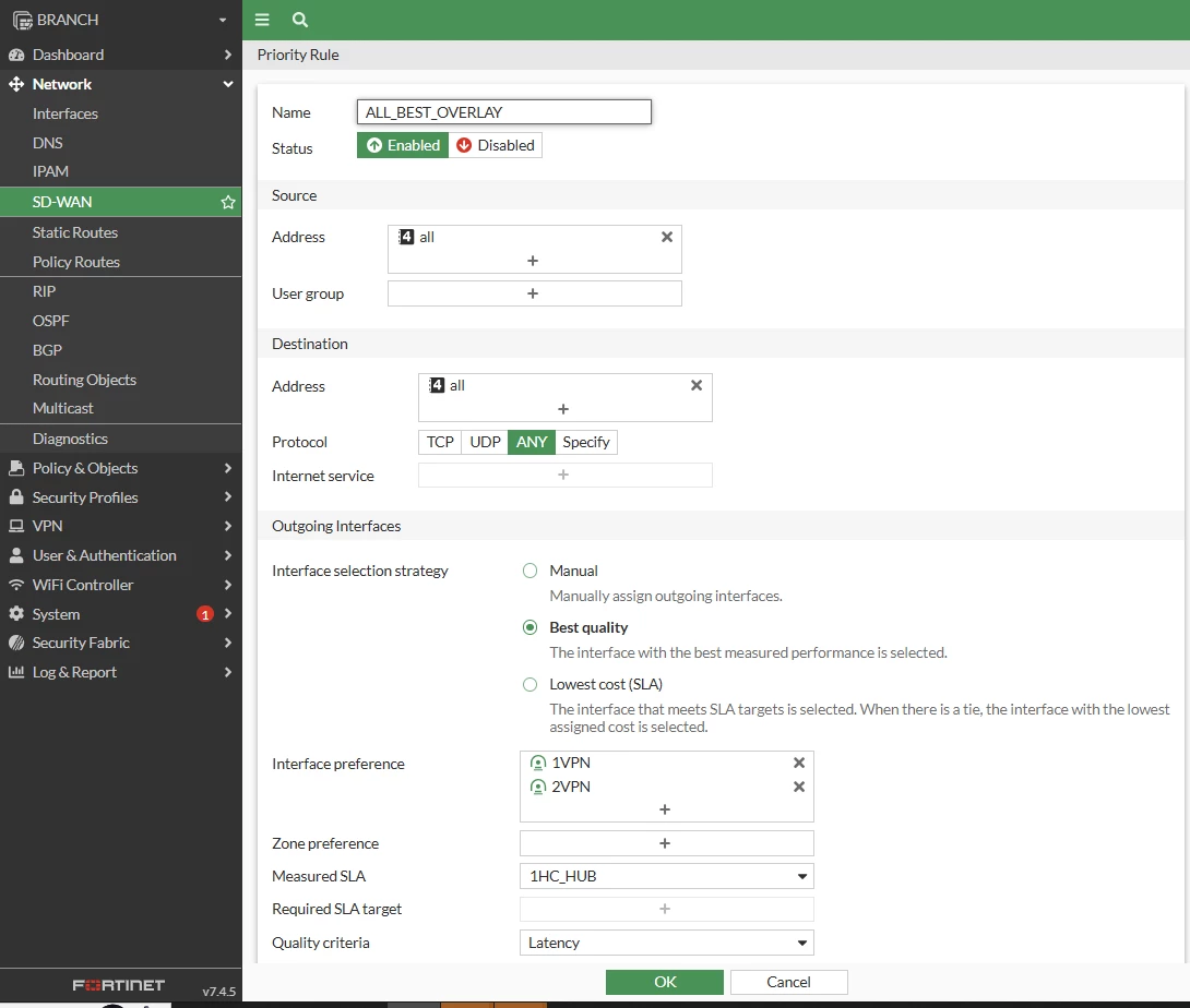

Create an SD-WAN rule with the Best Quality strategy.
CLI:
config system sdwan
    config service
            set name "ALL_BEST_OVERLAY"
            set mode priority
            set dst "all"
            set src "all"
            set health-check "1HC_HUB"
            set priority-members 3 4
GUI: Go to Network -> SD-WAN -> SD-WAN Rules -> Create New.

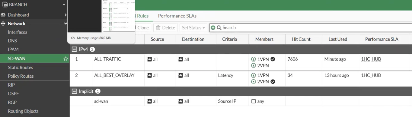

With the above configuration, there are two SD-WAN rules. When the first rule (Lowest Cost) is active but none of its members meet the SLA, the Lowest Cost rule is disabled and skipped. As a result, traffic flows to the next SD-WAN rule, 'Best Quality.' This rule selects the member with the best link quality, even if it does not meet the SLA.

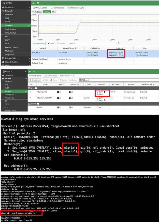

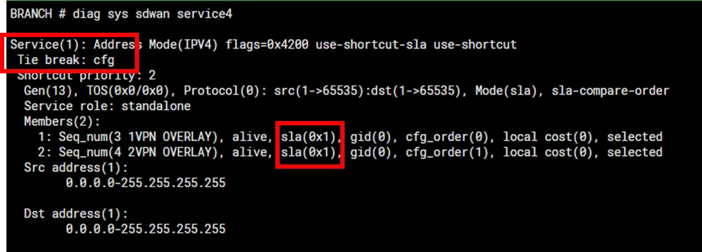

For the first rule, 'ALL_TRAFFIC', all members meet the SLA and have the same cost. Member '1VPN' is selected by the configuration order. The traffic is routed by the first SD-WAN rule by the member 1VPN.

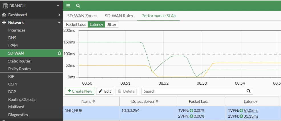

For the second rule, 'ALL_BEST_OVERLAY', the member with the best quality is '2VPN':
  • 1VPN: 61.05 ms (Latency).
  • 2VPN: 31.13 ms (Latency).

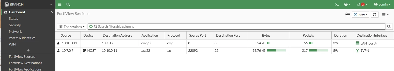

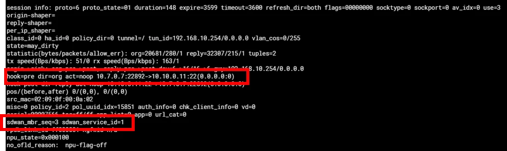

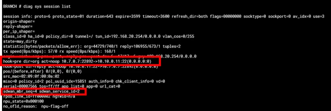

The 'HOST 10.7.0.7' opens an SSH session to 'SERVER 10.10.0.11'.
The SSH session matches SD-WAN rule 1, CLI command output:
diagnose sys sdwan service
diagnose sys session list

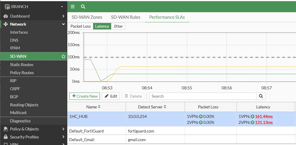

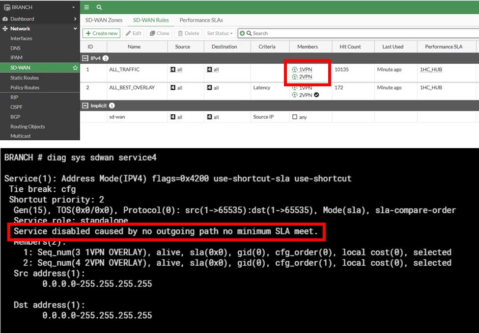

The delay of both members will increase to the point of not meeting the SLA:
  • 1VPN: 161.44 ms (Latency).
  • 2VPN: 131.13 ms (Latency).
The first SD-WAN rule (Lowest Cost) is disabled:

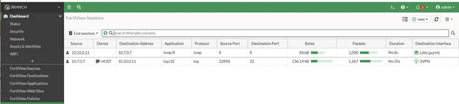

After the SD-WAN rule (Lowest Cost) is disabled, the SSH session will be routed to the next rule, 'ALL_BEST_OVERLAY.' Since member "2VPN" has the best quality, the SSH session remains active and supports the change without losing the connection:
If a member meets the SLA, the first SD-WAN rule is reactivated, and the session is back to the SD-WAN rule:
During all testing, the SSH session remains active at all times.
